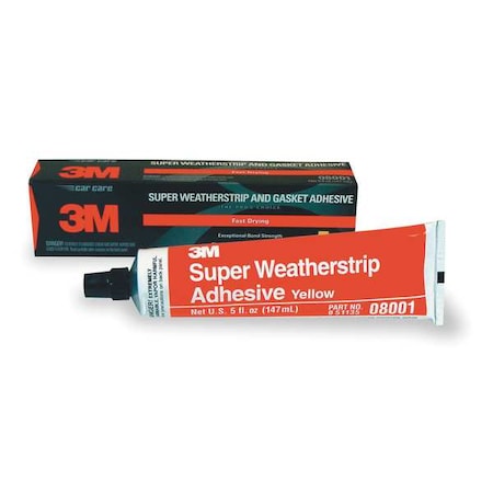

As a kid nearly 30 years ago, I worked for a mechanic in a 1 bay shop on a used car lot. He taught me a trick with 3M Weatherstrip Adhesive. A little dab in a socket, on a screwdriver tip, in an open end wrench, or even on your fingertips will hold a nut, bolt screw, washer, whatever until you get it started. You can clean it off tools and fingers with a little rubbing or some thinner when you're done.
I've always had a tube in my boxes since then.

thanks for the comments, I appreciate it, I don't like to use anything that is sticky (adhesive, electrical tape, or etc.) because of the mess and residue on your hands. The magnetic sockets are good in certain situations, if you have them, I haven't bought sockets in years, and I don't plan on it soon. Also, using paper towel will work even with deep sockets. Also, using the paper technique you may torque the nut or bolt in one step. Of course, many mechanics use many different techniques and most are usable and work great. I was just trying to add to the many ways to accomplish a task. I didn't have much help in the area of time saving techniques, so I will continue to try to help. Also, it's awesome to hear of other methods, the user has his pick. mike
