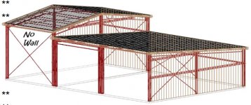

A couple of questions and maybe some of you have some ideas on this.
Plumbing - The city will allow me to put in a bathroom but no kitchen. That's fine. The city will NOT allow me to put in septic system which means I have to get my dirty water pumped up hill to the house plumbing. If I put a bathroom only on the 2nd floor structure, the lowest part of the plumbing would be at 10' and my house floor is probably at 25'. Are there systems out there that can pump the waste up to higher elevations?

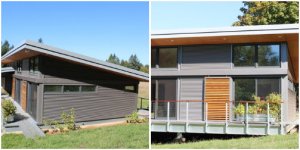

Aesthetics - I want to make the front and at least the side that faces my house not look totally like a steel building and dress it up with some wood siding. One building contractor suggested to leave off the sheeting on those two sides (they would engineer he building properly) and build it out with wood framing. This would reduce the cost of the building by a few thousand and can use that to build out the wood framing. Any thoughts on doing this?

Yes you can pump.
In general there are two options.
1) A grinder & pump system to pumps everything up to the septic.
2) A settling tank (basically a second septic tank) and pumping the liquids only up to the house. On occasion, you'd need to pump the second tank, just like the primary.
Neither option will be inexpensive. You'll need to decide how much it's worth to have a toilet in the shop.

To clarify my main house plumbing is not septic but I don't really think that matters. Grinder & pump may be the only way to go. I'll look into that.

You're going to want at least a mess sink in the main part of the garage on the lower level...so plan to pump the waste all the way up with whatever you buy.
Yeah...I guess if I'm going to have to pump I might as well just start from the lowest level and be done with it.
