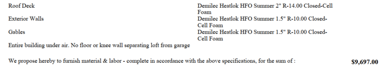

Thanks for the replies so far.
Out of the two closed cell quotes below, is the R difference worth the extra cost?

Are you going to be A/Cing the building? Are your doors panel doors or roll doors?

AC would be most likely the more I think about it, more so for pulling the humidity out than trying to turn it into a meat locker. Regardless though I would like to future proof the building as best as I can afford.
They are roll up doors, the two 12x12 will face north and one 8x8 will face west. I do plan on sealing and insulating them the best I can.
