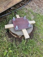

I'm building a cantilevered pergola using square steel posts with a base plate anchored to concrete caissons with J-bolts in the concrete. When I was sizing things I thought 4" posts would likely be plenty strong, but I wanted a more substantial look, so I went with 6" posts. The largest sonotubes HD sells are 12", so I bought these. Unfortunately, working from both ends of the equation here I am trying to squeeze things into too small a space. The largest 4-hole base plate that will fit on a 12" sonotube is 8". The problem is an 8" baseplate will not fit on a 6" post. I have 2 solutions;
1. Upsize the sonotube. This is a PITA, since I've got to source them from who knows where and the holes are already dug so I'd have to re-work them. Plus, I've already bought the 12" sonotubes, 8" base plates, etc. and I hate to waste all that, but this may be the more correct solution. The holes are dug and next step is concrete, so I'm re-thinking before the point of no return.
2. The easier and my planned solution shown in the drawing/picture (but now I'm second-guessing myself); mount the baseplate to the post at a 45 degree angle. The 8" baseplate wont fit the 6" post for proper bolt clearance when placed "normally" in a parallel fashion, but mounting it at a 45 degree angle with the bolts in the center of each flat side instead of at the corners, everything fits.
My question is; is there a structural issue with option 2 or a reason I shouldn't go that route? I've never seen baseplates mounted in this fashion, but I can't see why it would be an issue.

It won’t be an issue and it is not uncommon. How is the top of this column connected at the top? Another option would be to weld the anchor bolts to the base plate and embed the plate in the concrete. Then you can weld the column to the embed. This is a very common practice for exposed steel construction. A very clean look without exposed bolts.

Not an issue and not uncommon, great! That's what I suspected and was hoping to hear. The top of the column will be free standing, I guess you'd say, with a wood beam mounted at an angle, close to horizontal, "cantilevered", the post being its only support. Interesting alternate technique you describe. That would certainly fix the problem as well and I hadn't thought of that. This would make the install very permanent is the only draw back.

I don't quite follow how a 12" footing, 8" baseplate and 6" column doesn't fit, but a 4" column will be fine for this.
If you want it to look more substantial wrap it in PVC trim

If you look at the drawing I included, the 8" baseplate corners touch the edge of the 12" footing. The 8" baseplate fits on the 6" column as shown in the drawing, but if you rotate the baseplate 45 degrees to "normal" alignment, the bolt holes and corners of the post are on top of each other. The hole to hole distance on the 8" baseplate is 6".

There's nothing wrong with the anchor bolt layout on the sketch.
However, typically for 12" diameter piers, only a single number 8 rebar is what my office usually uses. Any pier with a column/baseplate direct on top will be an 18" diameter pier minimum, to get the anchor bolts inside the cage of the pier (those get a spiral cage with 6 bars around the perimeter). Especially if there's any significant shear or uplift on that column.
May or may not matter here.
A 12" pier with a square pier cap (sized accordingly) is another option.
Personally I would cut about an inch off each corner of the base plates and call it a day. They are probably overkill anyway so it certainly wont affect the strength.

All the replies here are focusing on the column base to concrete connection. No one has commented that the loads into the concrete are from a cantilevered pergola, and no description of that structure has been provided. Will the 12” pier be sufficient to withstand wind loading in combination with an overturning moment? Admittedly, I might be misunderstanding what the completed structure will look like.
That's exactly what I was thinking in over here just now...
If it's what I'm thinking, there will be axial, shear and moment on that connection, and probably significant values. The pier must have sufficient capacity for the loads, but also stiffness so it does deflection sideways.

Thanks for the replies! I pulled the trigger and poured yesterday. I used a triangle structure of 1/2" rebar welded together. Here is some additional info on the structure since people are asking...
Dig Doug posted several pics of base connection examples and it brings up another question I've had. Should the baseplates be mounted against nuts below them or against the concrete? I've seen it both ways and I'm not sure if there is a correct way or better way or does it depend on the application? If mounted against nuts should it be grouted?20240426_175433.jpg20240502_191554.jpg20240502_191600.jpg20240503_162738.jpg

I was a structural steel fabricator for twenty three years and there is a type of rebar specifically for welded applications. I don’t recall the alloy number right now. Rebar is pretty low quality steel but it works for what it is intended for. You can weld it but it isn’t structurally sound. In this particular case rebar is definitely required. You are treating the pier like a footing under a post that is connected within a framing system. It is far from that. It is an extension of the column which is very different. The rebar comment was mainly for the uninformed.
There are several things going on here. You are dealing with a bending moment, wind load and uplift. I suspect that you are way short of concrete and the base plate should be larger to spread the connection load. Like I said the engineers will be poking their heads in soon.

36" deep. Weldable rebar? You've got to be shitting me. Never heard of such a thing. It's steel, it's weldable. I'm not building the Hoover dam here. Rebar is not even required in this application by my City, I added it to go above and beyond.
Care to elaborate? Am I screwing something up majorly?
You may or may not be screwing something up, depends on what your structure needs for strength.
The way you did the rebar essentially made your footing the same as unreinforced concrete for the purpose of the strength of the J bolts, base plate and non-compressive loads from your steel columns. If plain concrete is sufficient for your loads, you're okay.
The rebar cage should be round and be within 2 inches of the outside of the concrete and extend to within 2 or 3 inches of the top of the concrete. The j bolts should fall within the cage of the rebar reinforcement. The function of the reinforcement is to hold together the concrete inside the reinforcement as it tries to split and crack as the j bolts try to pull out due to uplift and column twisting and bending. If the bolts are outside the cage, the concrete just splits and pieces tip off the outside, opening up cracks that allow the bolts to pull out. Your triangular cage would be useful for a single bolt that penetrated down the middle of the triangle, if the bolt was long enough to extend 6 inches or more into the area enclosed by the cage.
The concrete that is effective in carrying loads is essentially the part that is contained within the rebar cage. You have a tiny little triangle of concrete that is effective, the rest is essentially along for the ride, and for dead weight until it splits and cracks because of lack of reinforcement.
You essentially took ineffectual action, just to do something, instead of doing something that was useful.
