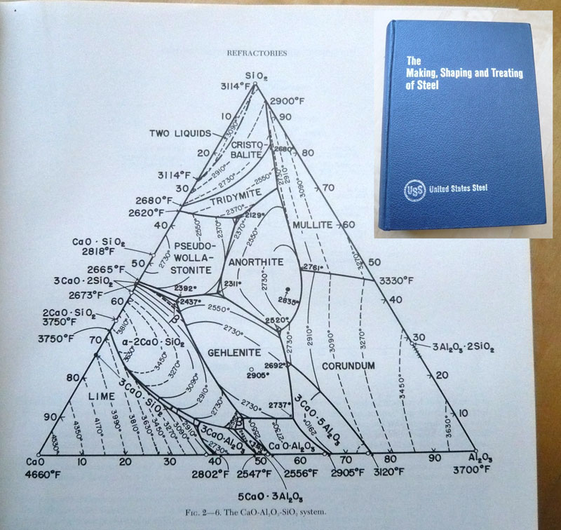

jpilgrim
Jan 27, 2009
237
I found this book at an estate sale this weekend:
The guy worked as an engineer at Bethlehem Steel.
I picked up the book to try to learn about steel, but as that one graph shows, there's a lot to learn...1420 pages!

Stuey
Jan 8, 2008
11,034
28m above sea level
lol at the terniary phase diagram. *grabs a 10 foot pole and slowly backs away from the evil*
