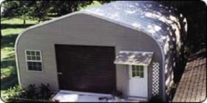

Things were going good , between my son, my brother and my brother-in law helping. I was trying to get as much done before the snow was to fly, but keep in mind I was only able to work on this on the weekends.
We were having trouble lining up the holes in the panels as they were sagging outward, the company calls it creeping . What it amounts to is the outside curves are like springs and the bends are loaded to have them line up...I thought that the lower baseplates would take care of it... i was wrong. the more we added to the building the more it creeped or sagged.
I decided to research more and in the manual there was a small one paragraph where you need to have 1 1/2" angle iron drilled at 24 1/2" centers to bolt the panels together to keep things lined up... I proceeded to "fix" things as best I could .
To make a long story short, I decide I'd skip a section and put up more panels, then put one in the middle when I get things pulled together and aligned. I am swallowing some pride here and really setting myself up for some "what the #$&@# were you thinking " comments but here's what happened. I skipped the panel and put up 7 more and braced them together...on November the 11th , I had to leave town to work on the 12th,the night of the 11th we had 152 m.p.h. gusts hit our town... here's what my wife emailed me...

I braced the building as best I could on the next couple weekends. And I caught a bad cold and couldn't work on it the 3rd weekend.Then for the next two weeks i was out of town trying to finished up our companies project for the winter shutdown.
I got a call form my wife that she heard the biggest wind storm hit our place... see attached photos, i almost cried...

These are pics of the shop after I replaced the baseplates and removed the damaged panels ... I am using straps and installed the endwall for strength.I will take more pics tomorrow as i have finished the outside bracing and am using 2 x 6 's to support the roof. If I ever get a couple days without wind blowing i could get more done..

I am trying to figure out which endwall I like the best as it doesn't have to be just plain...here's some of my choices...

Some have the ends plain...

Some have the endwall inset a panel which is cool but a wasted space...

Some have windows , i might need some natural lighting....

truck
Feb 8, 2008
203
Manassas, Va
Mine will look a lot like this with siding to match the house:
I also have 4 skylight panels in mine which is supposed to help a lot with natural light.

Hey Truck thanks for the post : I guess with 30' wide straight wall buildings, you can't have the skylight panels... That's what the salesman told me, there's too big of a span up top for the snow load...
