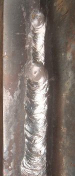

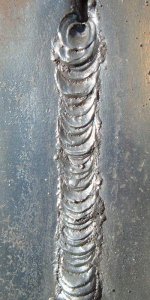

Look at the first pass in this little 2 pass weld. The operator simply held it and progressed up hill in a stringer fashion. Not so on AC7018, it takes a weave, really requires a quite a bit higher skill lever especially under adverse condition and poor fitment.
Look at second pic, operator had to work like a dog to keep it from all drooping in the middle. 7018AC.
You can see at the very bottom of first pic that I could make it almost flat if I was so inclined.
