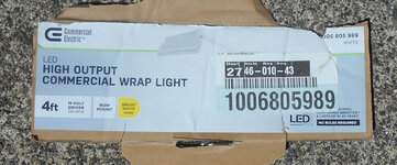

I have been replacing fluorescent bulbs at my sister's dance studio for over 30 years.
The last install was one of these: Commercial Electric 1006805989 four-foot LED fixture. $75 + tax out the door
The call it a "wrap" - no bulbs - just a strip with a mess of LEDS along the length of it. super lightweight with no ballast, so install was easy. Looks great. Almost matches the other fixtures on the ceiling. Much brighter than the fluorescent equivalents.
YMMV
