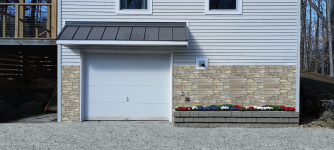

@CN Spots helped me out with some photoshop last year, and again this weekend. Think I've settled on something similar to this:
I really can't come up with an alternative wainscoting material, and the faux stone I've been looking at is foam based so will add some r-value to the uninsulated concrete.

I managed construction of a house where we poured it with smooth concrete forms (no brick design). The customer wanted a parged appearance so the mason applied it. Nice texture to it. Was painted which I was concerned regarding possible long term maintenance.
Fine stones like crusher run (we call it 21A here) has very small stones smaller than the size of the old Chiclets mini-gum (how many of you remember that!). These fines get stuck in the grooves of your tires and on your shoes and carry into the garage (and house if you don't take your shoes off).
Stones in your shoes destroy your floors. Stones in the tires, well you sweep the garage periodically.
We had 21A for around 7 years at our last house before we poured a concrete apron on top. It compacts and makes a nice driveway surface. It does not drain near as well as say #57, so make sure your grade is correct!
Whatever faux stone/veneer you apply, I would stop it inline with the lip of your garage apron if you plan on stoning, paving, concreting to that elevation at some time in the future. Should that occur, place your expansion joint material and then proceed.
The planter box looks nice. If you do that, consider waterproofing the house foundation within the limits of the inside of the planter box and provide the planter with weep holes. Many of our houses we have to address storm water (roof drainage) and a popular method is to build planter boxes contiguous with the house foundation. Downspouts are ported to these boxes. Special materials are installed to act as filtration beds and finally nutrient growth on the top to support the selected plant species. Thus, we seal the foundation wall exterior. Example below.

@larry4406 thanks, would not have thought about waterproofing. This time last year that was a framed wall...
I plan to glue 2" foam to it, inside the planter/hidden. Any suggestions on what I can get a gallon of? Planter will be stacked blocks, I believe there is natural spacing so plenty of weeping

Wow! Tore out a framed wall and replaced with concrete! Quite the project.
For small foundation waterproofing repairs, we use Henry’s Roofing cement. Comes in a gallon can (box store blue or orange). When warm (leave in the sun for several hours) it’s quite easy to roll or brush. Wear gloves is hard to clean off! Throw brush/roller away when done.
No experience with exterior foundation foam (insulation?).
When we have planter boxes on fronts of homes that have stone or brick veneer, we don’t run the veneer into the planter box. The veneer stops at the sill box level.

Easy enough to get Henry's, and yes, quite familiar with the mess. The faux stone veneer will stay at the top of the planter (saves $$ too) and I'll run some pink foam inside to get some insulation.
