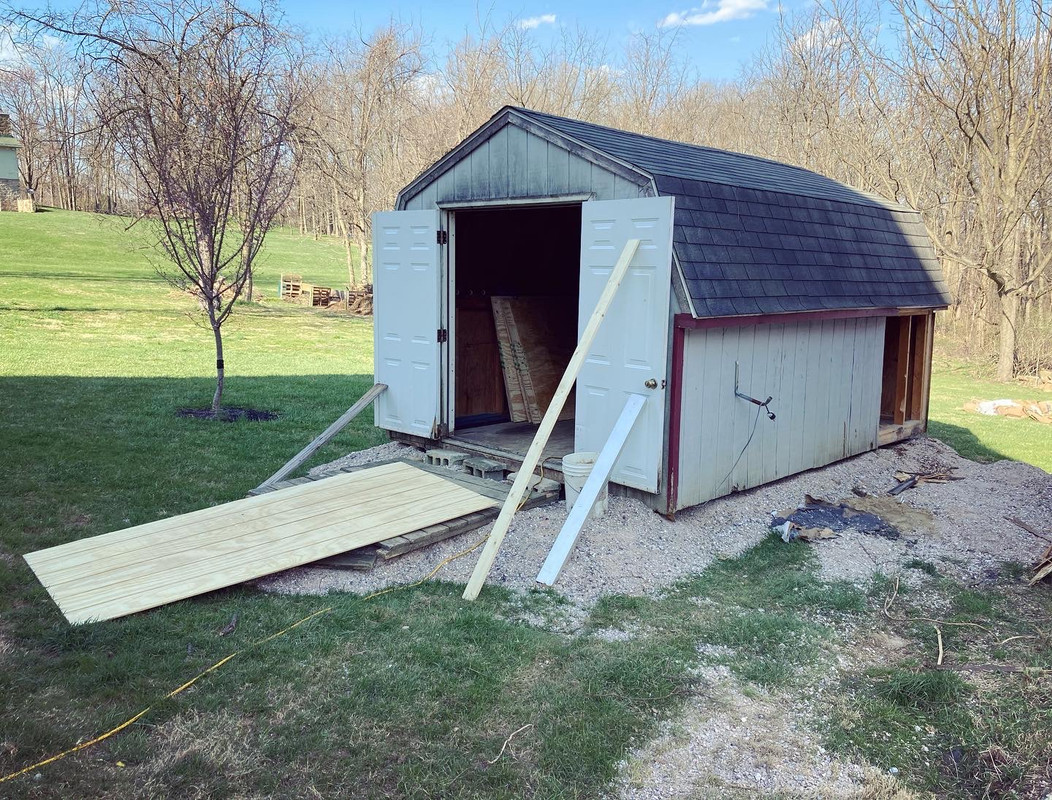

I did the same thing a few weeks ago.... I found a free shed on Facebook and it had to be delivered quickly... Couldnt get any foundation built or delivered fast enough so I used what I had and leveled it ... Holding so far but the wife hate the way it looks so Ill need to do a retaining something or other around it... Should do it anyway so the stone doesnt wash away I guess.... Any ideas for how to achieve something that looks good but inexpensively??? I was thinking planters or something... That would make the wife happy ;)
One thing I did do though was that I had a lot of broken cinder blocks and bricks laying around so there it a lot of that under the crushed stone... Bit of a stabilizer I hope
