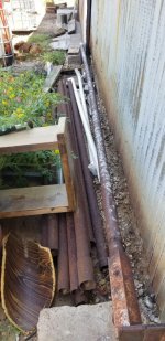

Most of my inventory is over 2' and some are heavy. I have a bunch of oil field pipe also. Space wise I have a lot just unsure where/how to store and I don't want to keep moving stuff(story of my life).
Lots of space in the loft but nothing to lift it up there.
