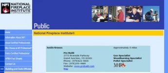

hmmm. Maybe I missed something... @rburke65 are you looking at going through the siding or the roof?
In either case how wide of an area do you between the ridges?
mrobins297aaa is correct. Use the right pipe! Typically their is a transition from single wall or double wall pipe to an ASHT or triple wall pipe the minute you penetrate a wall or ceiling.
I'm sitting here laughing because I'm sure you are wondering why a garage flooring guy is commenting on a fireplace. I had to be out of the industry for a couple of years because of a non compete and sold and serviced Gas, Wood and Pellet stoves and fireplaces here in Colorado.
