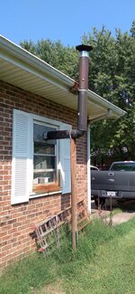

OK, Here we are heading into July. About three years ago I installed a small air tight wood stove in my garage. The stove heats the garage well but the draft at times could be improved. I heat with seasoned red oak and a bit of maple. What the problem is that the pipe is double, wall but outside the pipe is simply warm to the touch and there is my problem. Can anyone point me in the direction of something to insulate the stove pipe outside the garage? My stove pipe is well above the required height past the peak of my roof. I do not have the resources for "triple wall". All I am looking for is some sort of heat proof insulation that I can wrap around the pipe (6inch) to help keep the pipe hot and hopefully this will improve the draft.

So is the entire length of stove pipe double wall? Especially on the exterior of the garage?

It is all double wall all the way to the cap. I am thinking about insulation that is used in engine compartments. Like keeping the heat from the engine or headers from migrating into the cab of trucks/high performance applications. What wood be ideal is insulation for 6 inch steam pipes. However, not within my budget.

Ignoring the random metal zip-tied to the chimney and the interesting methods and materials used to secure the chimney to your house and support it - it's way too short.
Generally "they" say about 10 feet minimum of height above the surface of the fire for acceptable draft, but most recommend around 15 or more. Elbows also hurt draft, so you realistically probably only have 7-8 "feet" worth of draft. You likely need to extend that chimney at least another 3-4 feet to get effective draft.

That's an incredible hackjob install. Great way to burn your house down, and you even submitted it to your insurance!
Go do a little research here:
Double wall stovepipe is for interior use to the thimble (through wall or ideally ceiling) then you use double or triple wall chimney pipe.
The thimble will space the pipe appropriately away from all combustible materials.
The chimney then must go 3' above anything within 10’ horizontally. You also have 2 90's I there, so you need to account for the bends and increase the flue length to makeup the draft.

For a wood stove you need insulated stove pipe, double wall pipe is used in applications where the inner pipe is for exhaust and the outside pipe is combustion air, make sure you have the correct pipe for a wood stove, Class A. The two 90's could be causing some of your issue and I think adding a 4' section to the top or changing the two 90's to two 45's would help a lot. I don't think insulating the outside would do what you want.

It's understandable that money can be tight. At the very minimum you will need to extend the chimney by another 3-4 feet to get adequate draft. I'd probably go at least 5 feet more to be on the safe side.
Sometimes it can be better to save up a little longer and do it "correctly" to avoid issues. Triple-wall DuraVent pipe isn't THAT expensive if you stick with galvanized instead of stainless. Plus if you hunt around, you can usually find a good deal for chimney pipe on Craigslist or Facebook Market Place for people decommissioning old woodstoves.

Ken I think that your double wall pipe is to slightly reduce required clearance to a combustible surface.
I too was surprised how short your "stack" is. The rule of thumb (code) that a masonry contractor friend told me was
2' ABOVE anything 10' away horizontally. I would add the longest single length of pipe available, I believe that's about 6'. It will need to be secured properly and in the wind may cause your lower a rather flimsy (to be polite) looking "set up" problems supporting the additional pipe.

If you are using Type B vent, and if it is outside and not in an enclosure, then there is your problem.
Type B vent is only good for 600 degrees (IIRC, not an exact number) and the interior is aluminum.
I would be quite surprised if the stove manufacturer actually approves the use of Type B vent.
Class A fabricated chimney pipe or triple wall pipe for wood burning fireplaces has a stainless steel inner liner.
The Class A chimney typically has a flanged connection and V shaped drawbands for assembly. There is a ceramic fiber insulation between the two pipes. Triple wall snaps together (does not come apart) and there is an air gap between the pipes. The Class A stuff is quite heavy, and may need to be enclosed in a chase rather than being left outside in the open. Expensive, too.
Proper draft is a small number measured in inches of water gauge.
Your exterior installation probably has enough draft, but it is cooling off too much.

Just for some clarification. B-vent is for non-condensing GAS fired appliances ONLY. It is good to about 600*F. I do not recall the exact number. All Fuel or Type A chimney was regulated by UL103 up until the early 80’s. 103 had a 1700*f standard. It was found that there were to many structure/life losses due to fires at the 1700* limit. UL103HT was instituted with a 2100*f limit and that remains the approval rating for todays all-fuel chimney. The 1700* pipe is still the standard for oil fired chimney, but is difficult to find as most distributors will stock only the 103HT. Oil installs are plummeting and the 103 pipe will become even more of a challenge. 103HT chimney is available in both triple wall and double wall configurations. Dura-vents Dura-Plus is an excellent triple wall design given its ventilated starter section. It is not preferred however due to its larger diameter. It could not fit in a 16” framing without headering the ceiling/rafters. The pack chimneys from Selkirk and Dura-vent rule the roost due to the smaller diameter. The 103HT pipe requires a 2” clearance to combustibles. Termination clearances are 3’ above anything within 10’. They are minimums and overhanging trees and other obstructions may require more. You are always better to run the pipe up through the structure to conserve the temp in the pipe to promote good draft. Having a poorly insulated product will facilitate creosote production. A chimney which has seen a chimney fire should be replaced. The extreme temps inside the flue will frequently cause the pipe to expand so greatly that the inner liner will buckle. The double wall pipe used as the Vent Connector only are DVL and DS from Dura-vent and Selkirk respectively. They are stainless lined and you can use 45’s, 90’s and tees. This is unlike any 103HT pipe which cannot exceed more than 30* from vertical. The only 103HT fittings available are the thru-the wall Tees and 15 & 30* fittings. Many connect the 15’s & 30’s to make 45’s but it is verboten. On their web sites, both Selkirk and Dura-vent offer excellent work sheets detailing about every manner of installation you can come up with…with the possible exception of “through the window.” They call out the part number and location of every component. I did a lot of venting and combustion air training with the Wood Heat Assoc and Chimney Sweep Guild and the stories are chilling. To the OP, I am sorry to be a hard-***, and appreciate your situation, but I’ve spent to much time in my 6 New England State territory with the Fire Dept/ Building Dept on structure fires to have any patience. It is playing with fire and it shows no mercy if it is let loose

FTG, Well here's a couple pictures. My inventory of materials is as follows, 12 foot of 6 inch double wall pipe, 2 ,90 degree 6 inch connectors,1 cap. I had some flashing that is going through the window. I am well over 12 inches from the brick wall and the stove has a heat shield between the stove and the wall. I have a 10 foot pressure treated post supporting the outside structure. The only structure anywhere near the stove is the window. Yes I do intend to increase the vertical length of the stove pipe buy 3 or 4 foot when the resources allow.
In my own defense I use what I am able to afford. As mentioned I am on SSDI and my resources are strictly limited. I do not or will not put a hole in my roof. As to the double wall and the insulated pipe I have intentions of replacing the double wall with the insulated pipe for the vertical assent. Hopefully this will keep the insipid comments to a minimum. Oh yea two more minor items to add to the shopping list, one stove and a damper. Thank you for your concern,,, Ken

That looks like plain old single wall pipe to me. I certainly don't see any locking devices. And the crimp is "backwards".
Unless that wood post is petrified, it's combustible and in contact with what appears to be single wall pipe.
In my experience, people claiming to have "limited resources" still have cable TV and a fat cellular plan...

Sir, the pipe IS Double Wall. And the crimp is backwards you say? Please explain this. The pipe is sitting on a brick between the pipe and the post. Your experience's? Sir I get around with crutches, and have stage two prostate cancer. So don't tell me about your experience's. I am 65 years old a disabled vet with cancer and my future is uncertain at this time. I have limited strength in my right hand. So if I want to go an watch my satellite sports program I will. So get off my back.
