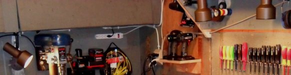

I really can't explain this. Yesterday at Lowe's I purchased a Fluke VoltAlert 1AC-A II voltage sensor. Looks like this;
I'll try to explain this as best I can. I had some track lights I wasn't using so I took them apart and hard-wired three of them as spot lights over my tool chest and one on my drill press. All three of them are wired to a single three prong plug which plugs into a power strip mounted on the wall. Please see the photo below, in it you can identify the power strip and the three lights to get an idea as to how it's set up. The light housings in question are brown.
The lights are operating just fine and have been for some time. I found this anomaly just playing around with the new voltage sensor.
Now, the issue. When the power strip is turned off via the switch on it the voltage sensor picks up no current coming out of it on any outlet nor is any current indicated in the cord to the lights. When I flip the switch to on the sensor will register the current just fine in places you would expect it to. However, the metal lamp housings register AC current regardless if the switch is on or off. Only the metal housings register current, not the cable, not my wiring, nowhere but the metal housings and bulb sockets. If I unplug the cord from the power strip then the sensor will cease registering current on the metal housings.
I honestly have no idea what's going on and it confuses me. Even with the power strip switched to off is enough electricity getting by to cause the sensor to trip? If so, why doesn't it get picked up in the power strip outlets or the power cable to the lights?

how are the connections made to the track light head? did you buy the bases for them or just hook some wires up? Are the metal heads grounded?

I connected the cables to the track lights with wire-nuts and electrical tape. No tracks are used, the lamps are hard-wired to the power cable. The ground wire on the lamps are connected to the ground on the plug. The plastic mounts/arms on the lamps are screwed into wood.
My big question is, with the power switch flipped to OFF why do the metal lamp housings show current but the power strip and cables do not?
Edit: Just in case anybody asks, I can feel no shock at all when touching the housings. I had no idea they would register any current at all until I used the sensor on them.

I would be willing to bet the housings are not grounded.
Have you measured the voltage on the housings using a real meter?
Assuming you have them wired right.....take a ground wire and touch it to the housings.
My bet is that they are not grounded.....
I could go into a disertation on how the shape of them funnels the residual AC in the air and causes the Fluke to trigger....but then you would need to be wearing your tin hat.

I agree with the rest, the voltage sensor is not the tool to use for this job. You need a multi-meter to read potential from the case to the ground. This looks to me like ghost voltage as some other have suggested, basically nothing more than I high voltage low energy charge on the steel housing. I would say you are fine to use the lights as they are, just make sure a voltmeter does not show potential to ground with the strip off.
