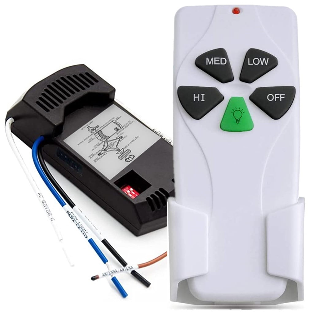

I don't see any pull strings on your fan, so I'm thinking it may have a module to control the lights and fan speed.
edit
the module was something like this

reading thru this thread i was gonna suggest this but you beat me to it... those wireless controllers can burn up and fail but not fully, causing weird issues with the fans and lights.

at this point, just replace the remote control unit inside the fan. I've only replaced a couple of them, but they seem to be generic.
I'm sure the electricians on here will tell you the same. No one is going to open up one of those to fix it since they are readily available. They're relatively low cost as well.
Does your fan spin?

You said you measured 25V at the bulb socket pin, which is why it the bulb is dim.
The controllers I've seen have two output one for light and one for fan. It appears the fan part is still ok while the light portion isn't.
I couldn't tell you what's inside the module or how it's wired inside the box. I doubt it's practical to fix just that portion of the module.
Since this fan doesn't have manual pulls, I'm thinking the best way to a have a functional and bright on/off system is to replace the entire module inside the body of the fan. It's not as much work as replacing an entire fan, and certainly cheaper than replacement of the entire fan. It's a wire nut job and zip tie job.

i have seen those wireless control units fail on one output and not the other.... other times both outputs fail.... theyre cheap chinese junk and i tell customers its better to have pull chain fans than the wireless ****... some oblige
