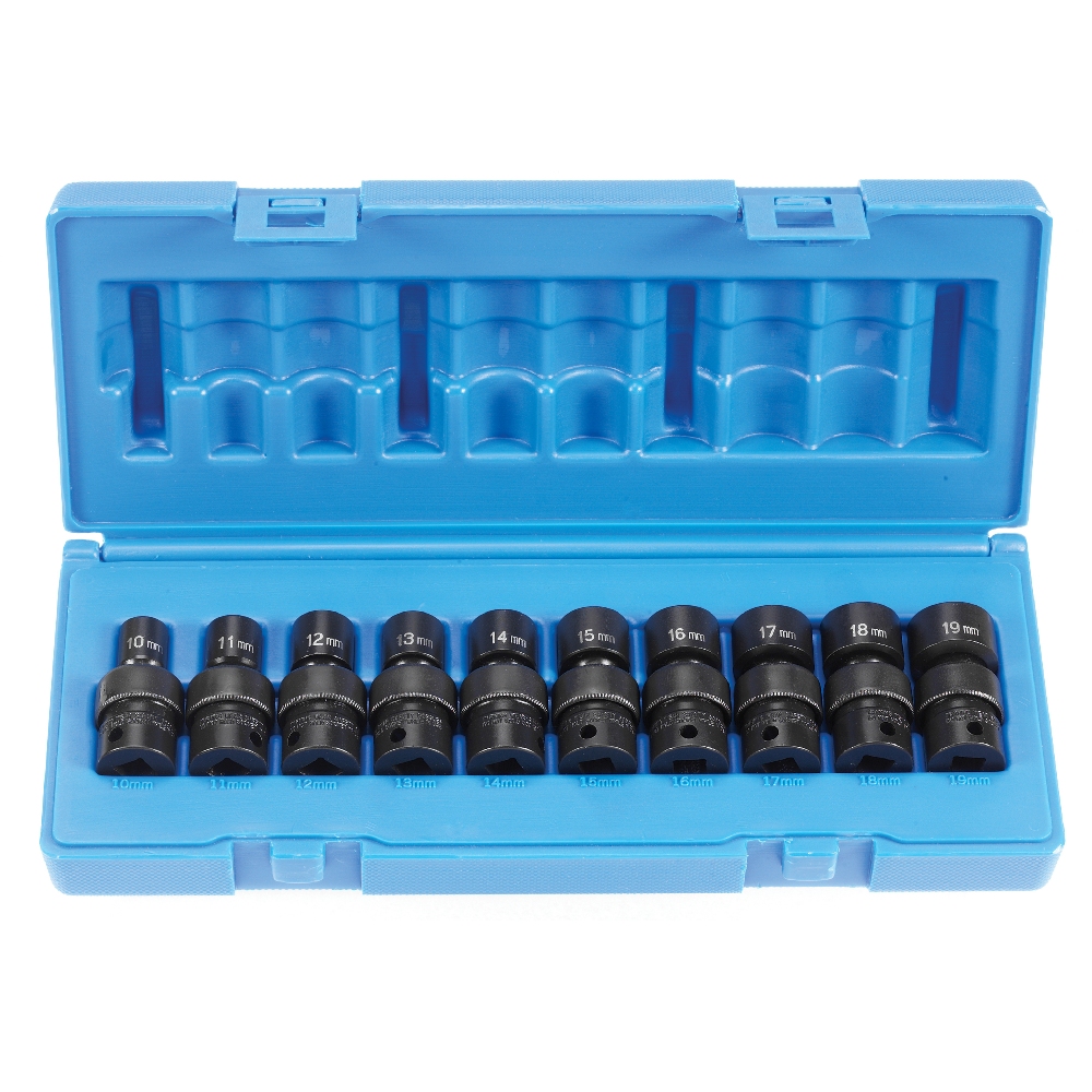

I vote grey pneumatic and ir. Gp has served me very well. I have not broken a socket or swivel in 7 years of pro use. The hex and torx are not as good.......but they get the job done most of the time. I bought a snap on t-55......to get the really tough ones. Other than the t-55 gp has always got it done for me. I have tried many of the top tier impacts.......I like the ir stuff the best. More comfort for only a SLIGHT power compromise. The new gun looks to be close in ergonomics, but ups the power.

The GP aren't well marked, I decided between SK & Sunex for this reason. Either of those will do.

For impact swivels, I like Gray Pneumatics. I have a 3/8's kit and really like them. They are holding up very well.

For impact swivels, I recommend armstrong. They have pinless impact swivels. They are the same as matco and craftsman, and actually craftsman may be the cheapest, but warranty with sears is not something I would bet on long term. I quit wrecking swivels when I changed to these pinless ones.
looks pretty well marked to me!

I based the marking comment on the short 3/8" impacts I have, they are only marked with laser etching, and it's wearing off. I don't keep them in the case though. Can't tell, are these stamped with sizes also?

Swivels would be sunex or craftsman/armstrong/matco.

I have always felt that there's one company in Taiwan that makes all of the impact sockets for sunex, grey pneumatic, and others. The only thing that changes is the color of the box it comes in.
The only difference between sunex and grey pneumatic beside the red or blue box they come in, is that sunex in addition to the gold high vis marking, has the socket size stamped in small numbers too. You can't go wrong with sunex or GP and if you shop around, you can get them fairly cheap too.
If you're worried about warranty, pick up a NAPA set of impact swivels. Same as sunex, but warrantied locally at your napa store.
I dont mind for lazer marking, they'll always be lined in a tray so I will get used to/ learn where what size is or what size looks.

Laser etched inpacts WILL wear off the info quick. You are kidding yourself if you think otherwise. But Agree, no sense in buying the tool truck stuff unless you are broke and need credit or it's a common warranty item like Torx sockets and such. Invest and save your money and have a great life instead of making the tool company rich.
Napa/Sunex are stamped and etched. I was curious one day and took a wire wheel to the etching... Still perfectly visible after the socket is down to bare steel. I guess the wire wheel must have been kidding itself that day :headscrat
I've only had them 4 or 5 years now though, I'll post an update in a few years if they do wear off.
of all my sockets that are not stamped (usually gold or white "laser" etching on impacts) none of the common used sizes are readable. Let them rub the ground and bump into each other for a while..you will see.

Okay so I am left with: if I were to go pinless- Armstrong or craftsman? Pinned- GP or gearwrench? And is the proto gun worth saving the extra $ for, or just go with the IR? Thanks for all the replies guys

Don't forget Sunex for the pinned, get the cheapest of the 3.

Don't cheap out on swivel sockets. This is coming from another pro mech. You are looking to step up torque wise with your new impact. You will tear up cheaper quality swivels all day long.
I personally still rock most of my Craftsmen/Westward impact sockets that I bought as an apprentice. But the only swivels that have held up have been Snap-on. I have tried Proto/Westward/Armstrong and a couple other I can't remember. And keep in mind when a swivel let's go, pieces fly. Always have your gloves/safety glasses on with them.
No it won't, my NAPA/Sunex hold up fine to my Ti MAX guns. My Matco swivels that everyone sings praises of, do not. I destroyed my 1/2 Matco swivel adapter in 20 minutes pulling a truck differential. They lock up if you hammer on them at a steep angle (which is the many reason for having an impact swivel). Once they lock up they're never the same and bind constantly.
