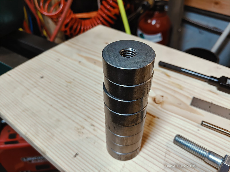

I've been sick this weekend, so didn't get much done on the shelves. Got the threaded "pucks" made that I'll weld on the bottom of the shelf legs to thread in leveling feet. 1.5" steel round bar, 1/2"-13 threads. Bandsaw cut, drilled and tapped on the lathe. Taping done by hand with a regular tap, just using the lathe to keep things centered.
Haven't yet decided if I'm going to have 6 feet or 8, so since I was already setup making these I just made 8.

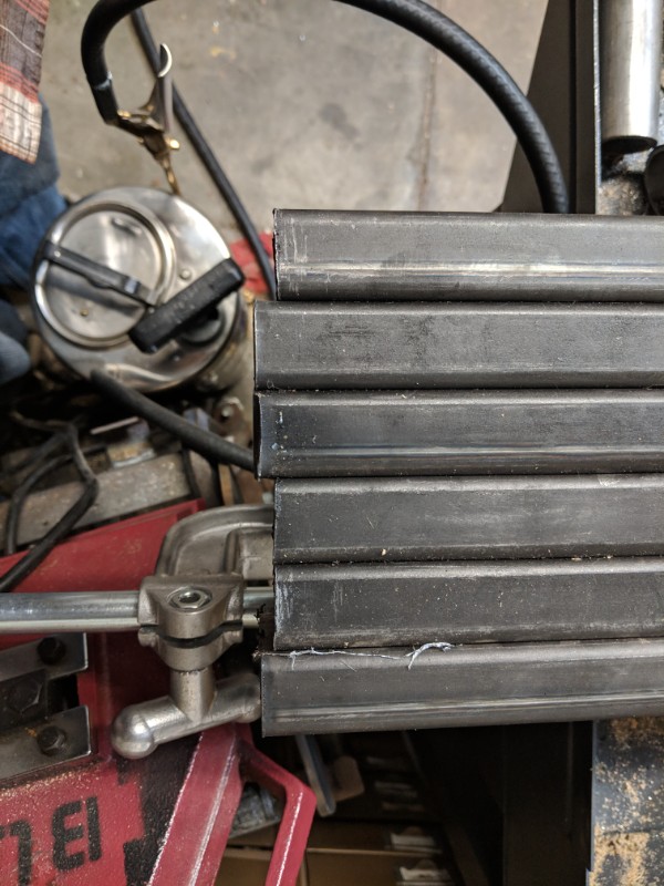

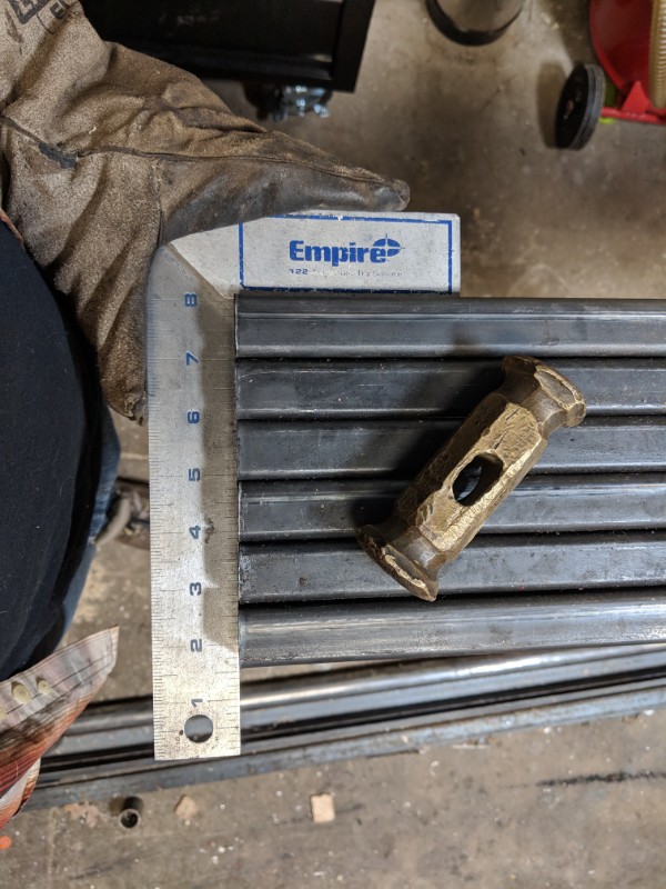

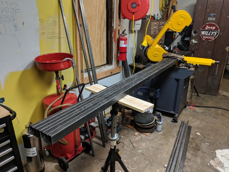

cutting the material for the shelves.
Here's how I square up the material with a small square. Don't assume that the tubing that you purchase is the correct length, or cut straight. Always rely on your own cuts if the lengths and squareness matter. Cut both ends if it needs to be exact.
I use an old hammer head (brass?) to tap the material into place. I've had it for a long time, it fits my hand nicely, and doesn't dent steel. Denting doesn't matter for this project, but it works very well just the same.
Here's how off the cuts are from the metal factory, the opposite end of the 1x2" tubing after I square one end. These will be the long lengths of the shelving. I only had 6 pieces in my storage, I'll have to pick up more to finish the shelves.

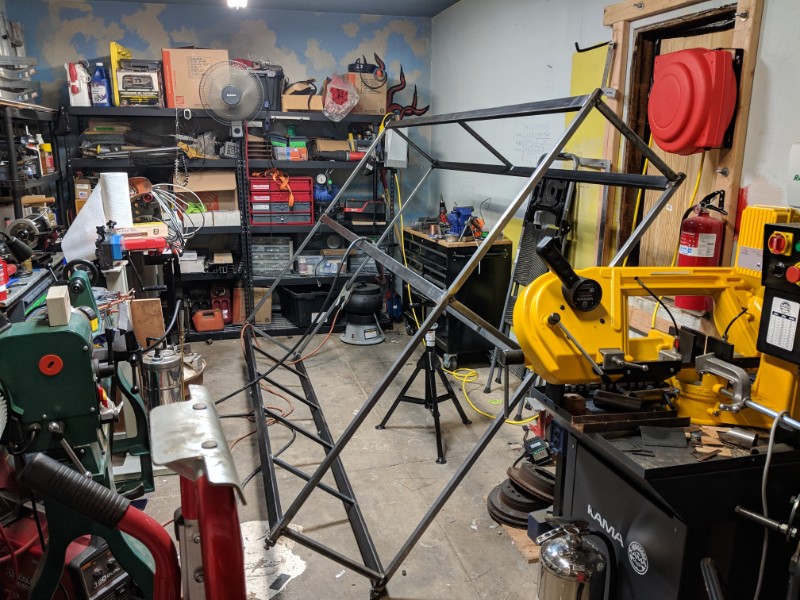

DanielBuck
What brand of "work support" is that under your steel holding it up for the bandsaw?
They are Sumner ST-881, about $75 or so each. I have two of them, and I'd not hesitate to recommend them, well made. I originally got them to hold up one end of a vehicle higher off the ground, and to hold a vehicle axle high enough to work on it comfortably. But they wobble a bit when they are extended. They hold static weight nicely, but side load is a bit wobbly, I didn't feel comfortable using them to hold a vehicle while my *** is under there pulling and pushing on the vehicle while working on it. Just don't like the wobble. Not that they are going to fall over, but if I had more rigid stands on the other end of the vehicle, I just didn't like part of the vehicle potentially being able to move.
However, they work GREAT for material handling like this though. You can quickly raise the tube (just grab it and move it up), and then do fine adjustments with the large acme nut. The tube is held by a large washer that is held at a slight angle, as soon as it catches it holds really well until you lift it upwards again. It's a strange way of going about it (I would have never thought to do it that way), but it does seem to work pretty good.
One of my next projects is going to be adding rollers to them, a roller that I can remove if I want to use the regular V head. I believe these are rated at 2500 pounds or something like that? Probably way overkill for a material handling stand, but they also get used elsewhere.
To set the height, I put a level on the machined surface of the bandsaw, then put some tubing in the vise held up by the stand. Put the level on the tubing and raise/lower the stand until it's the same reading as the machined surface on the bandsaw. That works pretty well. My floor in this garage is NOT flat, or level :-\ My old garage had a nice level floor.

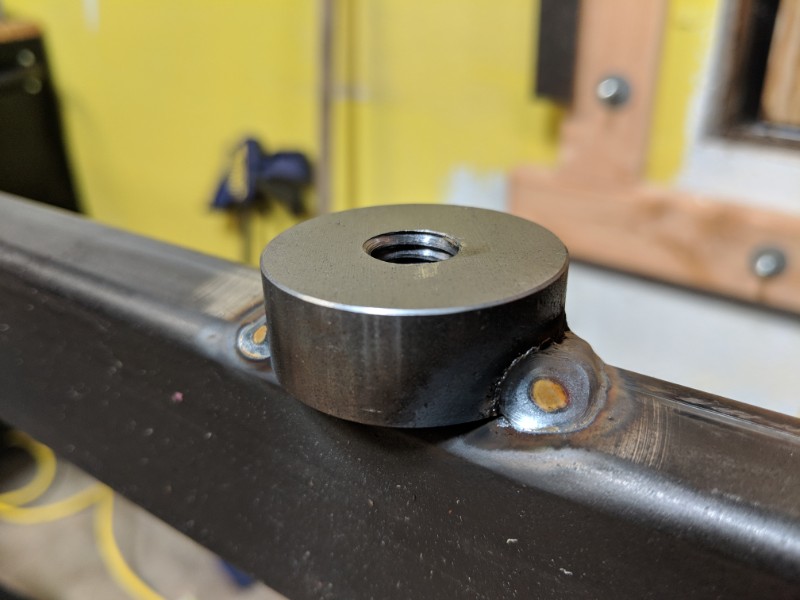

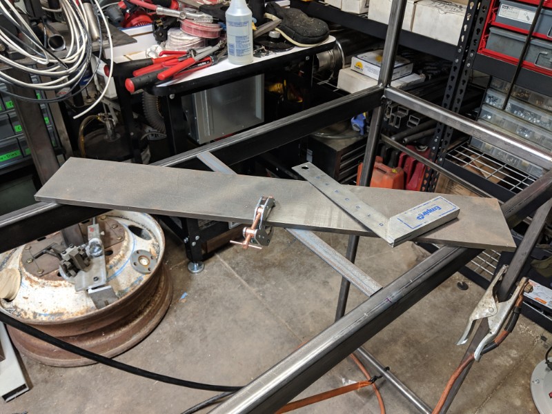

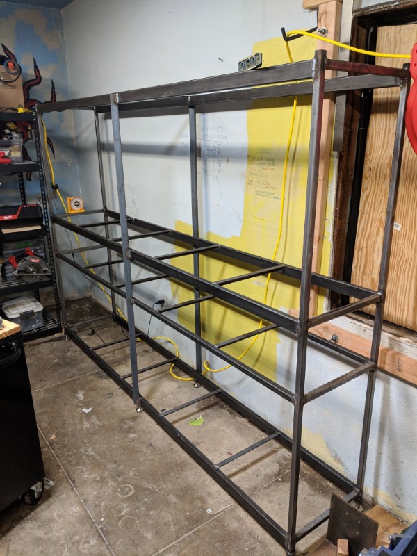

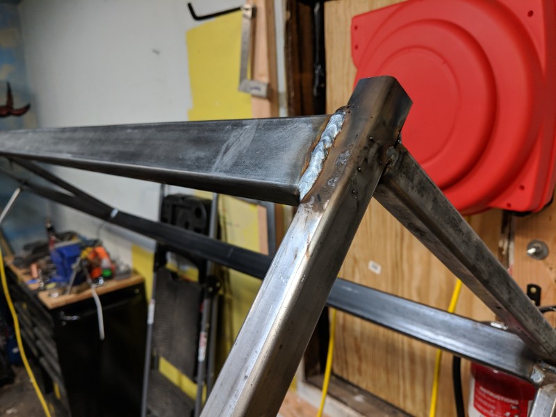

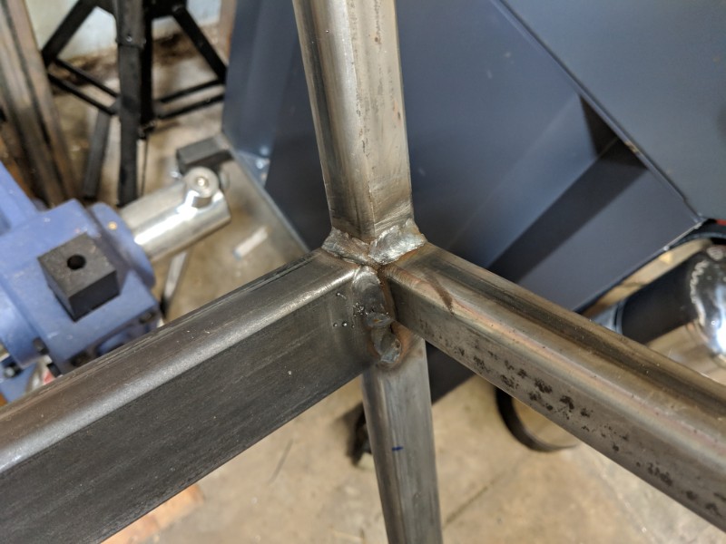

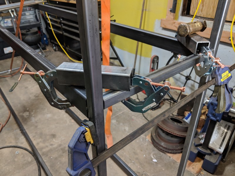

Got the 3 main shelves tacked and partially welded. There will be one more shelf about 1 foot below the middle shelf, and that will be where I'll keep all of my 1-2' long drop pieces, and short stock pieces for the lathe. With 9 feet of shelf, I think I should be able to keep the short pieces of material well organized.
I'm also going to add one brace to the back side of the shelves and a few more spans on the top shelf. But this is where i got yesterday. Also picked up wood to lay on the shelves. I'll round over the corners of the wood, cut notches where the corners meet up with the legs, and probably screw them into the angle iron cross pieces from the bottom. We'll see, once I get things on the shelves I may not need to screw the wood in place. Thoughts?
In the middle of the long spans I drilled a hole in the bottom of the tube (for the leveling feet bolts to have room to go inside the tube) and then welded on my threaded puck. On the legs, the puck is just welded to the bottom of the tube and the bolt goes up inside the tube.
And since the long spans were already measured and square to the legs (which takes a little while with just one person and no flat surface! Levels, squares, clamps and ratchet straps.... ), I just use scrap metal to clamp the short spans in to place for tacking. Quick, easy, and no measuring. Keeps them flat with the long spans.
Same with the angle iron spans along the inside of the shelves, use a thick flat piece of scrap to clamp the angle iron to, quick throw a square on there and tack it in.
After tacking, I tilted the shelves to get better angle for welding. I'm just a hobbyest welder... so I try to give my self the best chance to get comfortable. So far I've never had any welds fail on me. :shocking: My welding table is in storage right now, it's to large to fit in the garage :-( **** working without it

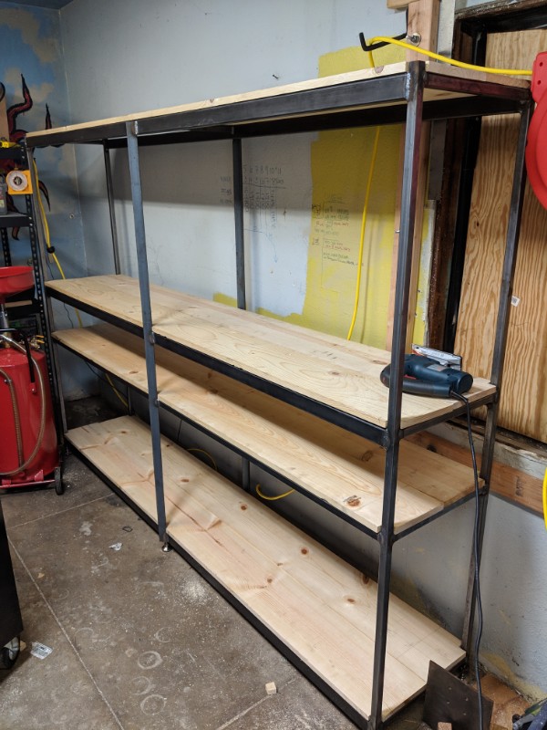

metal work on the shelves done. I'm PROBABLY just going to leave it bare metal. I never have a problem with things rusting in my garage(s) (my old garage never had problems either).
I decided to put a center support, putting good weight on the shelves would bend slightly in the middle (9 foot span), so this will keep it from bending. The angle iron will also allow me to easily run wires up the center post for shelf lighting and a few power plugs mounted to the shelves (right now the shelf is blocking 4 outlets.)
Will notch the wood boards and start loading things on there :)
D
danielbuck
Apr 15, 2014
931
wood is finished cutting. I thought about rounding over the corners with a router and staining the wood... but honestly it's probably going to get pretty beat up, so I think I'm just going to leave it as is.
I have alot of organizing to do, and alot of items to bring over from storage still. Heavy items will go on here, lighter items will go on the "1000 pound per shelf" home depot shelves.
