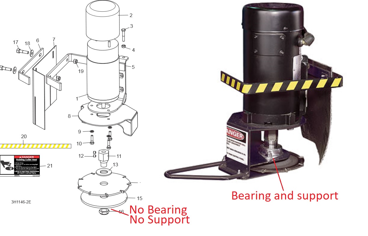

Background: I am fabricating a debarker for my band sawmill. A debarker is like a circular saw with 1/4" dado blade riding about a foot in front of the bandsaw blade. It cleans the pathway of debris, mud, sand, etc.. Typically, it more than doubles the life of each bandsaw blade.
Structural evaluation: There is a pivot point on which a 15 pound motor hangs. Since I do not have a lathe yet, and to save money, I am thinking about using the sprocket, crank, and housing off an old bicycle I have on hand.

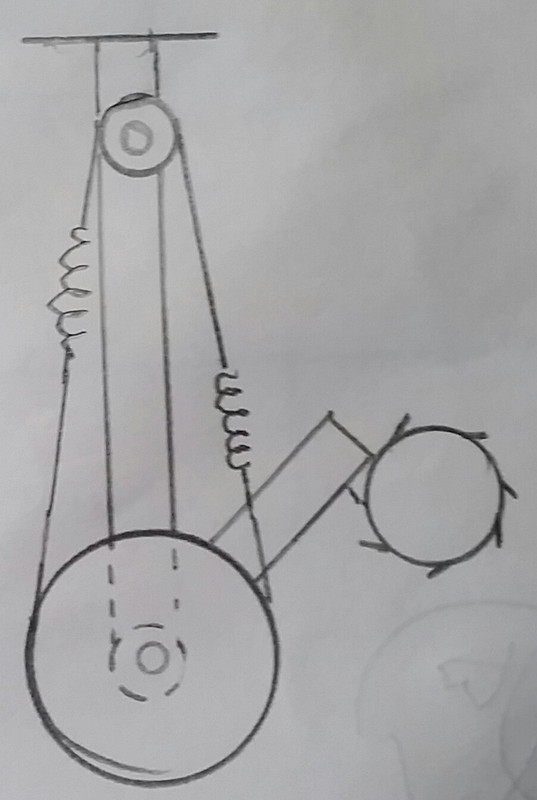

The small sprocket has a 1/30HP (25W) 60RPM 12V motor. It is wired through an on/off switch and another switch: reversable momentary on switch. You move the swing arm toward or away from the log by toggling the momentary switch. The springs in the chain keep tension on chain and more importantly allow the saw to move in/out with the imperfections of the log. The saw blade has a second 1/4" disc that is mounted right next to cutting blade. This disc is smaller in diameter by about a 1/2" or so. It keeps the debarker blade from digging in beyond the bark layer. The debarker is left out (away) from the log after the bark is out of the picture. So it only gets used on the first 4-8 cuts typically, or every cut for natural edge slabs. I attached a few pics to show my design and a couple of factory images. The springs may not work, so I am looking at another option. They can't go through pulley.

In my opinion the crank set is strong enough.
Capture the chain to the larger sprocket, so it can rotate, but not enough to feed the springs into the teeth.

Instead of a motor could you put the debarker on a spring loaded pivot with a guide wheel in front and behind the debarker?

I am actually toying with the idea of a locking lever to control the swing rather than the geared motor. My friend has one on his sawmill and it works in this irder: eyebolt, spring, cable around pulley, second spring, cable, through to operator side of saw head, and locking lever. You pull and lever clicks on locking teeth and the debarker swings toward the log. When you want to move it out, you pull locking handle and it wants to swing back away from log do to springs. I could go eye bolt, spring, chain around sprocket, second spring, cable through to locking handle.
