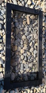

Best thing you can do for the glass is make a frame that either removes or swings down and put metal window screen over it. Make your frame material around 3/4" thick(I just used 3/4" plywood ripped about 2" wide) and staple the window screen to it. Paint the whole assembly black and mount it. I countersunk and glued a bunch of magnets to hold it in. Never have to change your glass again, or very very very seldom. I have probably 20hrs of blasting on mine since I've put it up and the glass still looks like new, every once in a while I pop it down and clean the glass but a blast with air keeps it mostly good.
