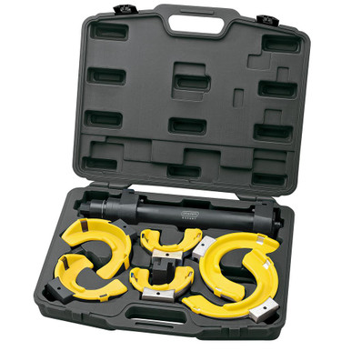

I use this type which I have made up a stand for;
I have never seen full struts available new over this side of the atlantic so we are generally always disassembling struts to do broken springs/ laky shocks/ rough top bearings.

First off, there is no spring compressor I would recommend for a budget minded person. Fixing Grandpa's Mini-Van isn't worth an accident.
The Brannick is the bomb and the one sold by Eastwood (and many other vendors) are the only two I find acceptable from the safety standpoint. KYB makes good stuff. Buy their version of the Uni-Strut and be done with it. How long is an 18 year old car going to last anyway? If you insist of using a different strut PAY a shop to swap them out. Easy money for them and it's the most cost effective way to do this job for you.

Another Harbor Freight hook style user; did the struts on our V70 a few years ago. Like a lot of tools, as long as you
(a) recognize that it can kill you; and
(b) work safely and carefully
You can get the job done for minimal cash outlay. If I wasn't feeling up to it, I would buy good struts and get them compressed by a shop that has a good wall mount--shouldn't be that expensive. I bought the tool because I expect I will do my Tundra's fronts one of these days... (Most of the pre-made sets are **** as everyone has noted.)

I have tried about all of them. Don't waste your time or money on the hook style. I did use the OTC clamshell style for a few years and it worked ok in some applications but not all and still made me nervous.
This is hands down the best money I ever spent on a strut compressor, the Brannick 7600. I built a cart for mine as I didn't have the dedicated wall space to lose. This is the best and safest strut compressor I have ever used and wish I wouldn't have wasted money on my earlier purchases as I was told they were junk but in my head I thought they would work for me. They didn't.

Buy the Brannick or the strut tamer 2 extreme. Either one would be the best. They both work extremely well. Choose your price. I think that the strut tamer is a little more beginner friendly, but the Brannick is very good. Don't waste time or money on the cheap tool.

The Macpherson type that Qualitytools mentioned above was the type of spring compressor that was recommended. I called around to different shops and labor prices were reasonable since I had all parts off the car (~$40-$60 IIRC). It would have been only a 30 minute or less job but they were all booked for weeks in advance. Recommendations for an $800 shop tool is ridiculous.
https://www.amazon.com/dp/B01DP2CDJU/?tag=atomicindus08-20
Video of how it works
I know this thread is a little dated, but for posterity/future searchers adding my agreement to using the tool above. I got mine 8 or 9 years ago and have done three of the family cars, the cars of several friends and loaned it out to a couple others. Great tool, very safe and a bargain for what they're selling for now. I halfway considered selling my old one for cheap and ordering the one above for the spring pads and the better case: (the one shown is now cracked at the hinges)
I just bought a cheap version of a set like that from amazon that has the plastic. Worked well on an e46. I was surprised that I actually could it move with a ratchet and not have to use an impact
M635_Guy
Dec 5, 2019
4,336
NC
Yeah - I think they frown on putting an impact on it (binding?), but I did use my M12 ratchet on it recently when I was building struts for my Mini. Worked fine. I'm very much a slow & steady guy when it comes to those springs. I get why people say "be respectful of the tool and the claw-style will be fine" but back when I was shopping for this originally (7/8 years ago) I saw enough videos where people made mistakes that I went to something that had more of a safety-margin built in.
