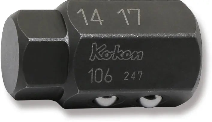

Something like this set with a ratchet or wrenchable top.
Great find! I'm not sure why I wasn't able to find something like that with all the searching I was doing last night.
Searching for "Stubby Impact Hex Bit Socket Set" brings it and similar products up. And then I just guess you have to look to see if the bottom of the bits are the hex design (that fits in the wrench) with the groove in the sides / corners.
I wish there was a generic term for bits where the bottom part is a hex (on the exterior) with a groove in it, designed to fit in a wrench. It'd make searching for this stuff a lot easier.
