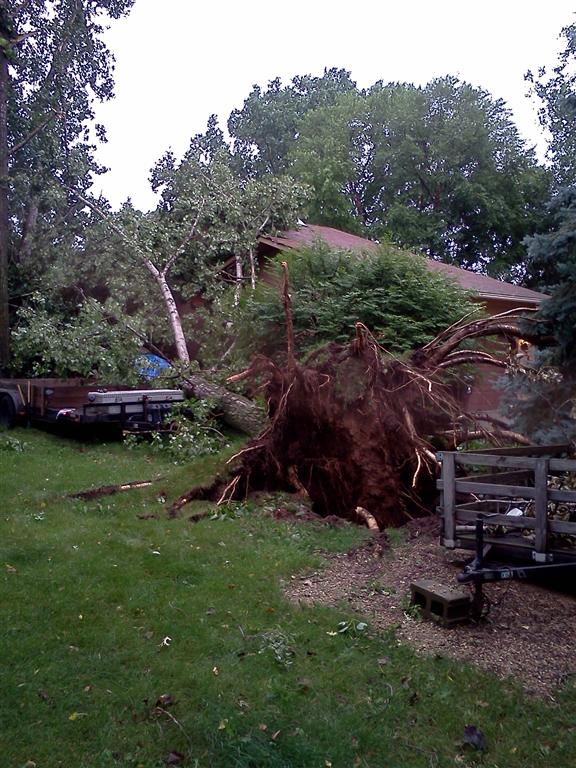

Dustball
Jun 25, 2011
2,081
Hudson, WI
will a 1.5 metric ton mini excavator with a digging force of 2600lbs be ideal for pulling up stumps upwards of 3' in diameter?
You didn't mention what kind of trees you're dealing with but here's an idea of the root ball size of a 24" dia trunk poplar tree.
The trailer in the background is 82" x 18' to give you something to compare it to.

Why not use a stump "grinder"...?
If you look at the pic of tree that fell over you see all the roots that spread out for many feet and go down deep. Most stump grinding contractors just cut off standing log and grind down about 6 inches but all roots are not cut and thet just take years too decay and concrete will not hold up
