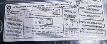

It's been a little while since I wired up a subpanel and I would rather have the inspector out once instead of twice so I thought I'd post here and see if I'm in the right frame of mind.
In the spirit of making an easy read here we go...
Overall Setup: 200A main panel in the utility room with a 100A breaker which is feeding a 100A subpanel in the garage via 1.25" PVC conduit. All wire is stranded copper, Red, Black & White wires are 3ga while Green is 6ga, Length of wires is ~27' total from lug to lug.
The Plan:
A - Neutral from the main panel
B - Neutral jumper to C
C - Neutral jumper from B
D - Black Positive from the main panel
E - Red Positive from the main panel
F - Ground from the main panel
Remove bonding screw
G & H - Neutrals from circuits ran from the subpanel
F - Grounds from circuits ran from the subpanel
Thoughts / Comments? Did I miss something?
