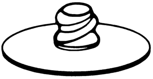

The answer to your question Ben is yes, they make Roloc discs to fit angle grinders. I'm assuming you mean a common 4 inch angle grinder. 3M makes them and they're real simple:
All you do is thread the backup pad to your angle grinder and then thread the Roloc disc to the backup pad; that's it! The backup pads come in different female thread sizes depending on which grinder you have (5/8''-11 most common) and they also come in different firmnesses. The Roloc disc would be the type TR and the material is their Scotch-Brite surface conditioning discs. Let me know if you need any help with the part numbers and sources to purchase them from.
