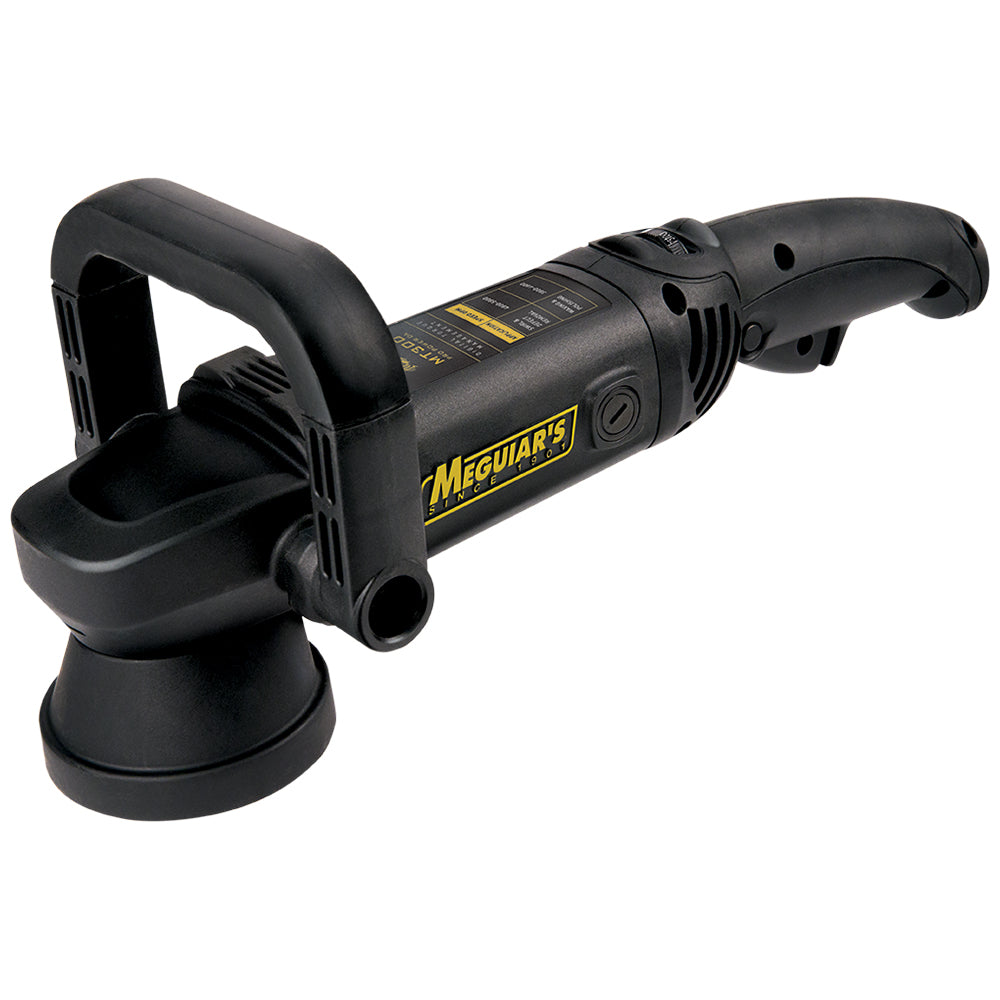

For Budget you could go harbor freight Bauer. Pretty good product i have to say. It served its purpose well.
Then to upgrade from there you could go Meguiars MT300. Great product for the hobbiest or weekend warrior. Could go full on busniness with this one but its not as efficient. Little time consuming still being a 8mm throw.
Then you get to Rupes. True professional product. the first is a 15mm throw (ill explain at the bottom of this list) and the ultimate one is the rupes LHR21
Ok so a quick explanation if needed. 8mm throw will take a while and a few of each stage pad per vehicle where a 21mm throw will correct in half the time with approximately 1 pad per vehicle.
