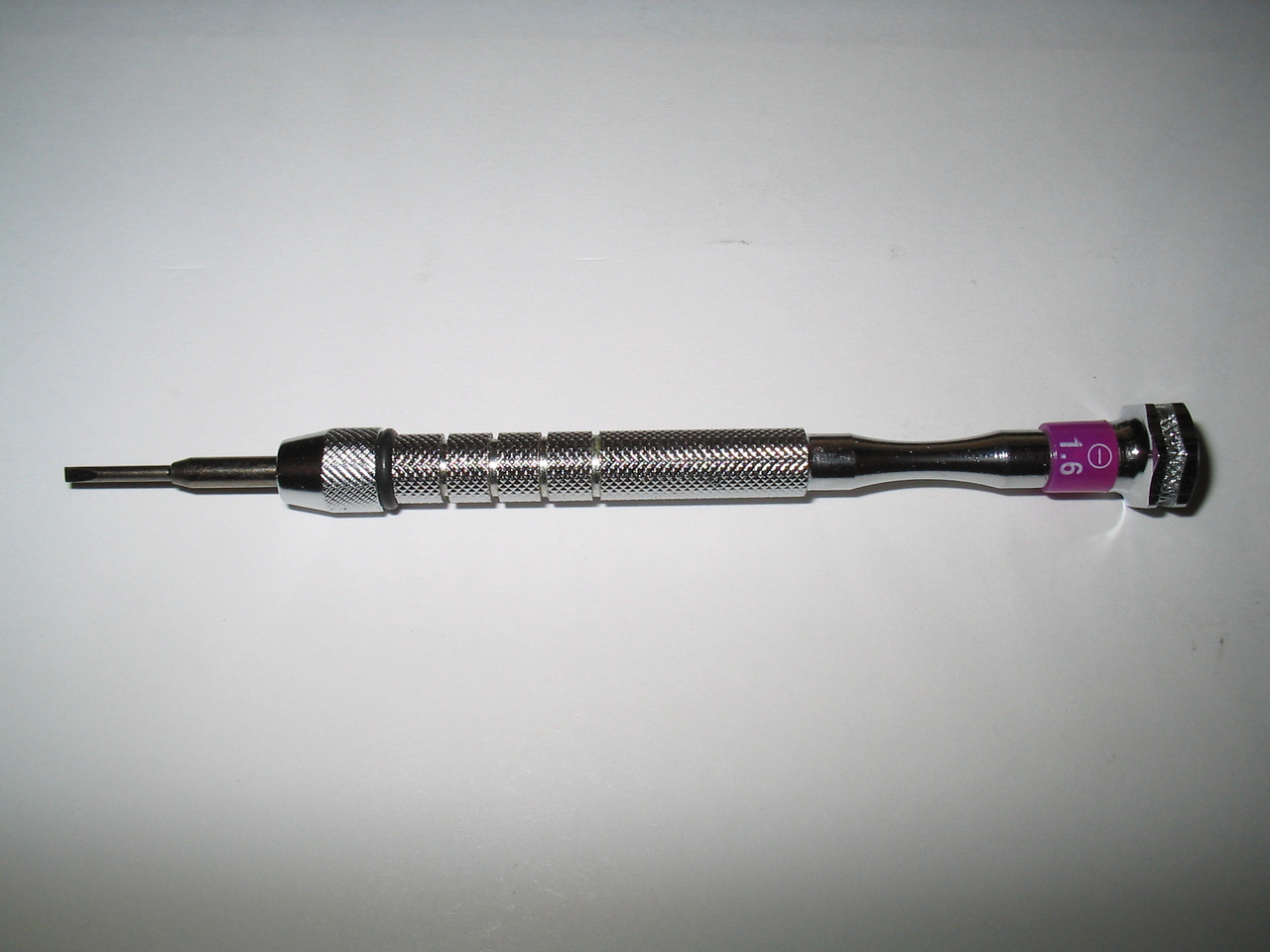

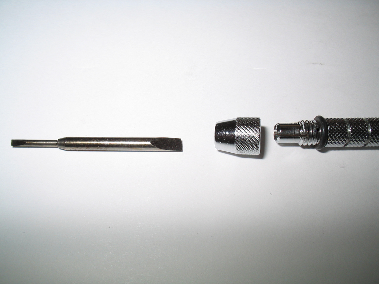

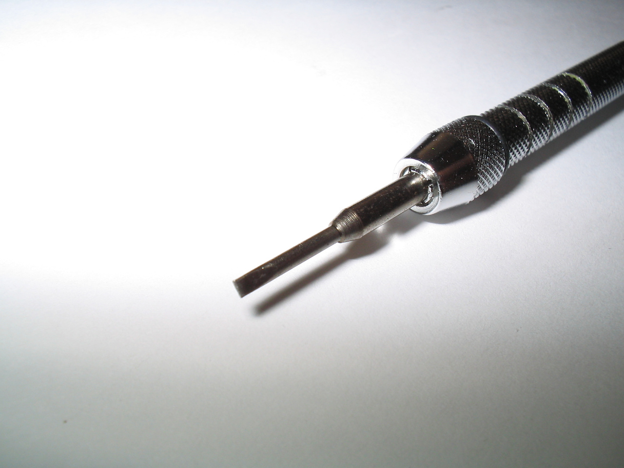

I took some pictures of the one I mentioned above, just in case anybody's interested... This one is my most-used. It's about 5 years old and is used for maybe 50 extremely high-torque (relative to their size of 1.0 to 1.6mm thread) screws every day. Out of all the drivers in this size I've ever used, it's got the strongest tip by far. The design has a *lot* in common with some of those from ofrei.com posted above, but not identical to any of them. They are about $8 each or $65 for the 9-piece set and rotating stand in the picture above.

The standard for watchmakers is generally considered Bergeon. Replaceable blades and can be sharpened. Starrett makes a suitable product at a lower price point.
