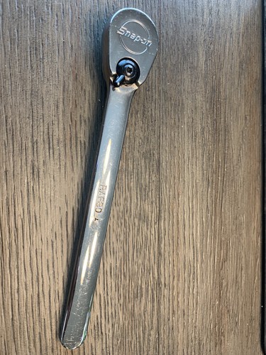

Looks like the OP already found what they needed but FWIW I have two of the Snap-on RAF80As and I also have the Nepros NBRC390S.
The Snap-on is 10.44mm thick.
The Nepros is 11.19mm thick not including the quick release.

I have the Snap-on RAF80 and there have been several spots on my BMW that it has come in handy when paired with the low profile sockets. One job specifically was replacing the front wheel bearing. If I didn't have that ratchet I would have had to taken the steering knuckle apart to get to a bolt so it saved a ton of time.
I guess you need to get under the car and see the problem because, from the armchair, it seems that a combination spanner or a ratcheting combination spanner would fit with plenty of room to spare.
