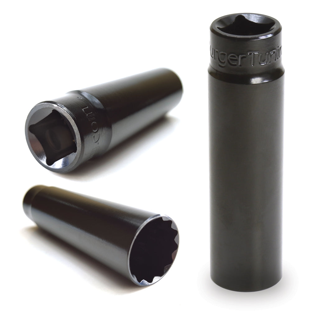

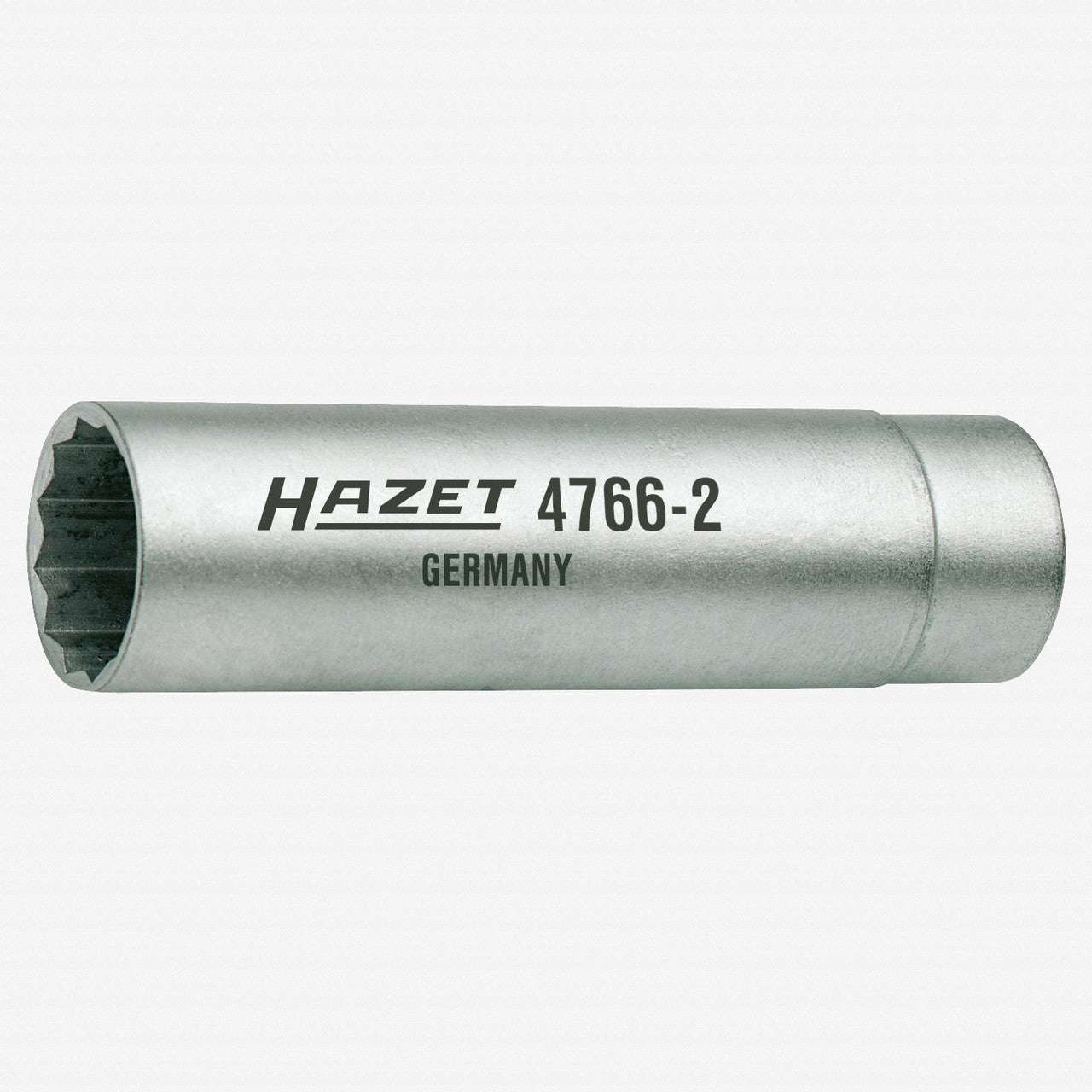

$140 for a German specialty socket doesn’t seem unreasonable. Honda sells a S-O spark plug socket for the super rare commuter Hondas for a measly $76. Pay the $140 and move on. But please use a $15 Pittsburg Pro ratchet when you use it!
That's just a socket Snap On sells though. They say it is for "Nissan® 1.8 L Versa® and 2.0 L Sentra®, Mercedes® and BMW® vehicles" on their website, they don't even mention Honda.
Pretty certain the factory tools for the Japanese cars have their own domestic tools for it, and certainly also so for Mercedes and BMW - the actual factory tool is likely make by Heyco or Hazet.
It's possible it is the Honda USA representatives which may officially recommend it. But it is just an alternative they choose on the US market then.

The correct garage journal answer is: "Weren't you thinking about getting a lathe anyway?".
The thought did cross my mind...
The OP has already informed us that a Porsche forum member can make a socket that fits for half the dealer special tool cost. Why should he pay the $140 and move on? GJ members are notoriously frugal and resourceful in my experience, but this thread has a few who just give up and say buy from the most expensive place.
The irony and the banter here are hilarious.
He’s spent countless hours trying to find a solution to a problem that already has an answer. If you like that kind of project that’s cool. but he’s not going to find a $20 socket unless he’s really lucky.
I think 30 minutes? I've spend more time reading this thread than sending a few $ to a rennlist member who made the tools.
Glad OP found a different option.
I think the original point was not that OP couldn't afford the expensive socket, just checking with the GJ Brethren for potential cheaper options for a tool that will be seldomly used.
Nothing wrong with that.
My original thought was a local member with a lathe who wanted to make a few bux and a little project...
