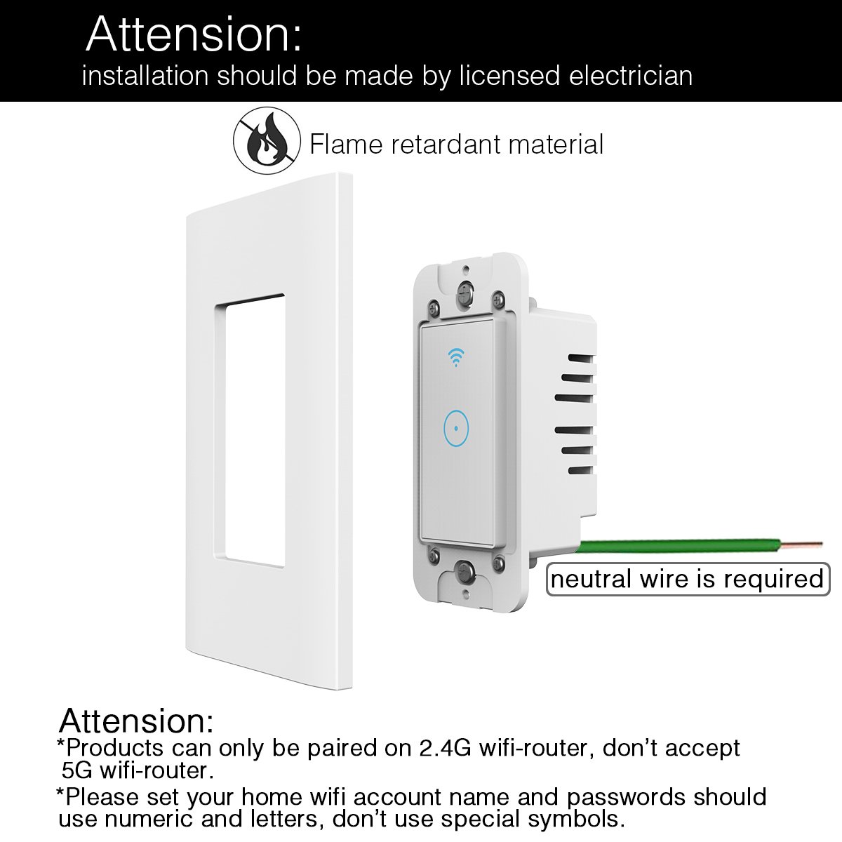

Not really a dimmer. One is a timer for exterior lights. One is a WIFI(iP) switch.
Normal switches have the tabs you can break off. These are flat tops with no tabs. Like Below
The are meant for a standard switch box. I think they will fit in a single gang gfci surface cover for a 4x4 box...but haven't confirmed yet. Also thinking I might out a plastic box next to the metal one for the Wifi Switch.

however the Zwave switches I have seen have the same problem with not having ears I can remove to fit in a surface cover.

Could change box to 4 11/16 and have room for the ears. Do either of those switches have an antenna wire that routes outside of the box? I installed a Chamberlain/LiftMaster that had one.
Also found that a deeper box helps as the bigger switches can block the cable openings.
You also get a free Jinglish lesson with this device.
Attension: Do not fits square mudring box.
Watch yourself on Amazon!

Yeah the WiFi switch is a gamble...has good recent reviews from so called "Verified" reviews, see how it goes. I have it setup to go in a plastic box when it arrives. For the $25 bucks worth a shot.
