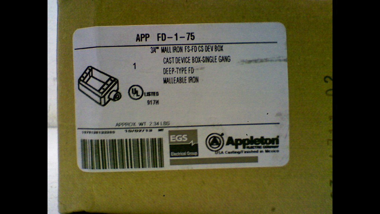

So what I got now:
SOOW cord 10'
FD box 3/4" cast iron, single gang "dead end"
special single gang receptacle cover made for FD box. (not sure what else I could use)
Cord relief with mesh grip by leviton
Grip with "loop" for ceiling cord
generic cord relief for ceiling box
metal box for ceiling, cord will be using the folded and not welded side.

But it’s not code compliant to use a four square/1900 box like that.
I got this box
So do I really use a lock nut on the outside as a jam nut? That will decrease engagement of threads.
Is the fitting going to tighten into the hub thread like a NPT pipe?

Look at the threads on the Kellems grip. I think they are NPT threads.
Gland connectors could be either.
2 screw connectors have straight threads.
None of them will need a locknut if they're sufficiently tightened

OK I got my stuff and it does have a tight pipe thread, so it is not going to come loose
One concern now I weighted the fitting, box, and cover it is 2.75 lbs.
The box and cover is made of cast iron. The weight is just a bit more than I thought it would be.
Mine is FD, 2.34lbs If it was FS it would be 1.96 lbs. I am thinking if you walked into it, it could hurt.
I have ordered SOOJ 12/3 cord with .59" diameter, it's a thick one, hopefully all will work well.
Is there an aluminum version of these boxes?
Yes, there is.
