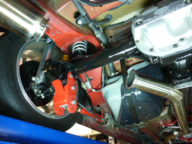

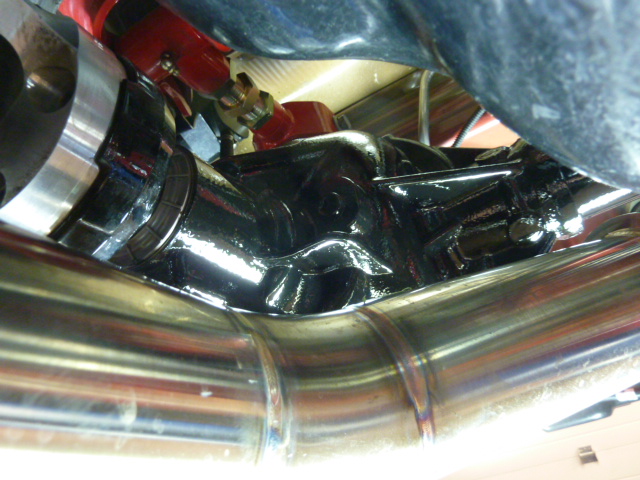

Here are some pics of my Integra's suspension which was done with the Eastwood Chassis Black:
All of this was done 3yrs ago and it's holding up well but the car sees very very little use as it's a track day toy and is a CA car (no salty roads). But it has seen some off track excursions which undoubtedly put the suspension through some pretty terrible debris. All in all I wish I would have taken the time to have it all powder coated but at the time it just wasn't really practical in regard to time or money.
