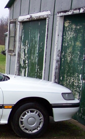

Not sure if this helps, but here's a pic of some folding type doors my dad put on this garage he built in the 70's. (I don't think they've been painted since then either
) I don't know where he got these doors.
