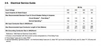

I remember when I was setting up my 300 amp welder, the information miller gave me was no where near code. When talking to the electrical supply company about it they said welders are always weird and to just follow the manufacturers chart. I also discussed it with an electrician and he agreed. I have never had any issues and I used 6 gauge wire with a 100 amp breaker 90 feet of wire. Here is the chart from miller:
Actually if u go through the code section that deals with welders, u will see that its based on duty cycle. Code allows a higher rated breaker with a lower rated wire and outlet FOR WELDER CIRCUITS BUT the outlet MUST be labeled 'for welder use only'!

Actually if u go through the code section that deals with welders, u will see that its based on duty cycle. Code allows a higher rated breaker with a lower rated wire BUT the outlet MUST be labeled 'for welder use only'!
K sparky, where in article 630 does it state that?. The labeling part that is.
