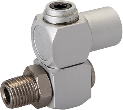

Does anyone have recommendations for a swivel for use on an air tool at the connection to the air line?
It appears that the most common style is this:
https://images-na.ssl-images-amazon.com/images/I/61sKX+ibIyL._AC_SY355_.jpg
but I also read a fair amount of people saying they leak easily. Understanding that you need to take reviews with a few grains of salt, what are the thought of users here?
My use would be attaching to the air tool, then attaching a quick release to the other end. I am not using any leader or whip hoses at this time, I just want the added flexibility. I use 1/4 NPT adapters to attach to the tools with Auto (T/P) style 3/8 connection, like the Amflo CP5, with 3/8 air lines. I mention this because I am aware of plug ends with a built in swivel, but most I see do not use the 3/8 plug.
I am open to any ideas and suggestions. Aside from the bias to the 3/8 vs 1/4 plug and coupler I don't believe I am opposed to anything.

I have a few of the ones in the pic, from HF.
Does not work so well on certain tools though. The hose hanging down actually gets in the way or drags on whatever your working on.

i use the ones in the op, work great. work out to about $3 a piece
bluepoint sell the exact same ones, rebranded and marked up by a big margin.
swivels great, haven't had any leaks yet

I have the ujoint style on all my air tools. Harbor freight has them for 4 dollars. when they start to leak replace the oring with a quality oring and they last forever. So far I have had all mine for 7 ish years. Beats the 35 dollar tool truck cost seeing as i have 8 die grinders at work alone.
I have only had to change 2 or 3 orings as well and that is from really torquing trying to get a gun or ratchet into a tight spot then pulling on the hose with the fitting likely pinching the oring. Abuse for sure.

We use the blue point ones at work. Maybe 1 in 3 tools have them and we have maybe 2000 air tools give or take in use and like faiee we don’t have much issues. They hire a guy once a month to walk the plant and identify air leaks and it’s rare for them to identify the swivel. More often the tools with whips have leaks.
As to preferring a whip or a swivel it depends on the tool. A die grinder or scribe gets a whip in my box, everything else a swivel except an impact which is just a coupling. Air impacts are slowly disappearing due to the one key Milwaukee fuels

Yeh I use these too, had big brands and HF ones and HF ones do just as good, use daily in my shop and replace or fit new seals as needed .
Love them on my nano impact wrench and reactionless impact ratchet .
They so cheap, flow decent, minimal length and decent movement range it a no brainer .
