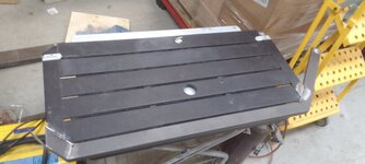

Friends moved several years ago from a large house to a smallish high rise Condo . their outdoor table came with them but it was a tad too large for the balcony and you could only sit at one side because there was no room to get around it .
Me being me, I suggested I cut it down for them to a more usable size , so we went from 36x72 to 36x36 . here are a few pictures starting with the table as built, on to cut down to size, prepping to weld it back together , welded back up ( I'm not a welder & very thin metal so don't criticize too hard ) bondo'd & prepped for paint , then painted. for some reason the table in location screws up so I will post that on a second post

Thanks. ^^^ nothing worse in my opinion than making an alteration that shows it was altered . if you're going to do it, do it right.
with the left over pc I may make a smaller table that they can put their grill on , but that's to be decided .

Looks like your next order of business is to "right size" the rug.
Nice job on the table though.
