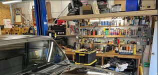

Here are a couple of before shots but I have no recent shots with the finished woodshop in the back, dust collection, mini split I added, etc.
54259155534_b6b50ee508.jpgScreenshot 2024-07-20 at 9.51.37 AM by E A, on Flickr
54258029882_23f8eb6bd7.jpgScreenshot 2024-07-20 at 9.52.15 AM by E A, on Flickr
54258030837_defe3b8864.jpgScreenshot 2024-07-20 at 9.49.00 AM by E A, on Flickr
54259341140_0ea030de20.jpgScreenshot 2024-07-20 at 9.50.36 AM by E A, on Flickr
