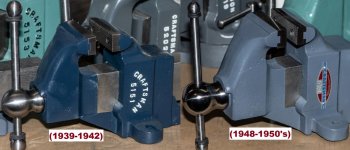

I was quite shocked when I initially saw one, a big 6" 5166. I doubted its authenticity, but now I have seen quite a few, I have 3 of these myself, this 5151, and also a 5162 and 5163. All of these date in the 1950s, at the same time the 519x vises were being advertised. Its why I argued that Sears continued to have a working relationship with RI as they were selling 519x vises, and why I believe it supports my thinking that 519x are made by RI.
drivesitfar
Oct 23, 2013
36,075
so you have 4 sizes with these Heritage badges on them? even though i've got several 6 inch Rock Island vises i'd love to find the 5166. have you ever seen a 5168 or was even advertised or offered?
I think you need to start your own thread so we can see your entire collection instead of in bits and pieces on various threads? or do you have one already that i've missed?
EDIT: i just took a closer look at your Heritage badge and it has 5151 stamped in it. very cool!!
E
ed4banger
May 28, 2016
470
Virginia
I have 3, the 5166 belongs to another member here. The 5151, 5162 and 5166 each had the model number stamped on the heritage badge. The 5163 had a regular heritage badge, and an additional model number badge. I have never seen any of these larger than the 6". I've been thinking about starting a thread. Here is a "before" and "after" pic of the 5163 badging.

I believe that Reed and Rock Island Craftsman vises were being sold at same time as well. Long C Reeds, heritage badge Reeds, meatball spindle, flat nose spindle. Rock Island changes only appear to be the lettering, curved, upright and heritage badge. That is, until they intoduced the 519x series. It would be interesting to see your date stamps for all and the evolution of those changes. As far as advertising goes, I simply think they showed the newer models, but continued selling and possibly manufacturing the older versions. I also believe the wartime period played a significant role in what was available and who was able to supply Sears.
Hoorn
May 19, 2020
1,140
Glendora, CA
These not made by Reed, made by Rock Island. I have pretty much all the Reedsmans. Few of them actually had dates on them.
Ed, I know yours are Rock Island, I was responding to SweetD's question regarding his Reedsman and how to date.
Fierljeppen
Jan 26, 2018
1,159
My thoughts exactly. Rock Island Mfg. (Birtman Electric), was heavily involved in the WWII effort, so for the first time in many decades, RIMCO wouldn't be available to supply Sears with any machinists vises at that time. This is when Reed Mfg. picked up the slack and supplied Sears with their vises, (1943-1948).
While the Rock Island Mfg. Craftsman vises were the same as the military version, the "Craftsman and model" castings would have been removed before production. This would be why the badges had to be installed later, to replace the missing "Craftsman model" castings.
As the ad below indicates, there was a surplus of Rock Island machinists vises post WWII. The fact that they would be available as a Craftsmans machinist vise offers strong evidence of the relationship between Rock Island Mfg. and the Craftsman 519X vises as well. ed4banger is starting to sway me to calling that particular "vise puzzle" and moving on.
This is just a plausible theory, based on real evidence...nothing more, nothing less.
What you say makes some sense, that these may have been war surplus vises, but what about the slide dates from the 50s? Could the slide dates be other than manufacture dates? Perhaps a released for sale date, similar to Wilton warranty dates on their slides?
Fierljeppen
Jan 26, 2018
1,159
The vise castings were more than likely manufactured and stored in mass, while the machining of the vise was usually done just before it was assembled, packaged and shipped. I suspect Rock Island Mfg. had a surplus of machinist vise castings and not necessarily assembled vises, ready for sale.
I believe the date stamp would have been a reflection of when the machining of the slide took place, which would make the 1950's date stamp plausible. I can't think of any other obvious scenarios at this time.
Thanks for providing an interesting weekend vise puzzle.:beer:
Thankyou, I've been trying to understand the presence of these heritage badged RI vises for a while now. This all seems to make some sense to me now.

I've been looking into this today a bit, I do not believe the "634" on Maui's vise is a date stamp, for a couple reasons. First, its too nice, it looks cast. In looking at my own Cman RI vises, I found some with numbers cast in this fashion and location, but they were all part Nos. corresponding to Regular RI vise models, like "592". In this case, as best I can tell "634" does not correspond to a RI vise model. Second, in reviewing what catalogs I have (David Maher collection) The RI 51xx vises didn't make an appearance until '39. The only other RI offerings Cman branded were the 52xx series around '32-'33.
To answer your question re date stamping, I do have Samson vises as well as Cman 52xx vises date stamped mid 30s .
I was always under the impression that my Craftsman vise was manufactured by Reed. And Reed did date stamp their vises in this location in this way.

Ed, how did you reach that conclusion? There is no date stamp on the slide like there is on my Rock Island vises.
The lack of a date stamp on the slide is not uncommon, often worn away. I have seen quite a few with indiscernible indicia.

Ed, there is no indication of a date stamp ever being present on the slide on my Craftsman 5163. But I can clearly see the date stamps on the slides of my Rock Island vises. Maybe my 5163 was made by Rock Island and not by Reed. I don’t know. I’m not looking or a debate about who made them with anyone here, I’m just asking if you could provide any evidence you’ve gathered that supports the opinion that they were made by Rock Island. So far I haven’t seen any that I can recall.

5163 is a Rock Island, basically equivalent to the RI 594. Reed only made the Craftsman 5179-5188 bench vises.
