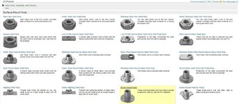

I have a cabinet with drawers that I'd like to put on casters. The cabinet has 4 threaded inserts or nuts on the bottom designed to put on wheels or leveling feet. The threads are 7/16x14. I have 1/2"x13 threaded casters laying around that would be perfect for this cabinet.
Can I tap the threads one size larger? I could buy 7/16x14 threaded casters but they aren't a common size, so they aren't cheap. I'd like to use what I have laying around.

I assumed the OP’s casters have a 1/2x13 male stud (not a baseplate) that he wants to thread into an existing 7/16x14 nut by retapping the nut to 1/2x13.

They are threaded inserts. I think I can drill out the threads with a 1/2” bit and then weld a 1/2” nut on top where access is easier.
Then thread on my 1/2” casters.

Got it done. The threaded inserts broke away when I drilled them out. I should have spent more time cleaning off the oil I used in the drilling process before I welded the nuts on. I just wanted to get it done. Welds seem strong. I took a wrench and tried to crank the nuts off.
The cabinet is much thicker metal than a typical cabinet of this size. It was tough picking it up and putting into my Jeep. Someone was giving it away for free.
Thinking about putting my old Lincoln buzz box on it. That thing weighs > 100lbs. There are 4 mount points on the bottom of the Lincoln that I could use with nuts and bolts to attach it to the cabinet. Throw some welding tools / disposables in the 2 shallow drawers and my helmet in the large drawer.
