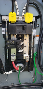

Good morning everyone. I am planning on installing buried cable for my detached workshop. I plan on 100A (110 / 220) service run 175'. I will be doing all the work myself...I'm not an electrician but retired from the USAF in electronics and worked as an electrician apprentice for a couple years. Finding reliable contract work in my area is a big problem for some reason.
I'd like to simply use buried feeder cable but want suggestions. 2' depth, 2 2 2 4 AL MHF or URD with conduit above ground and #6 wire and 2 ground rods / 6' apart and not tied to the subpanel common at the workshop. ???
I'd like to start my run by tapping onto the main service disconnect located beside the meter box. It is a 200A disconnect with feed thru to the main panel inside of house. I've read replacing that panel with a QO1816M200FTRB type (as an example). I'd appreciate any advice on how best to accomplish this and of the overall project.

so you want to tap in on the load side of the breaker?
that can is way to small to make splices in...
also depending on what you will be running, #2 AL is a little small for 175' run...

i wouldnt want to use that since you have no way to properly insulate it from the metal enclosure

Space is going to be the biggest energy. I've done it once where I stripped the insulation back a couple inches on the existing wire, slid a Polaris connector over it, and added my tap to the second hole.
Didn't take up too much extra room

So I should be able to come through the bottom of the panel with 1/0 Al using Polaris Connector on the load side?

Thanks for the replies. So, I'll use the 1/0 1/0 1/0 Al Triplex URD cable tapped (using the Polaris 3 Tap connectors) from the load side of the service disconnect (given enough room if not I'll research for a different panel); buried 24". Conduit on the above ground both inside / outside to each panel...with insulating bushings (as advised). Sound like a good plan? Again very much appreciated.

You need a 4-wire feeder and single rated URD is not rated for or permitted to be inside structures.

Are you worried that the PVC conduit is going to rub through the insulation?
NEC 300.4(G) states that wire #4 and larger need to be protected when entering an enclosure. It lists four ways to do it, but a bushing is the easiest and most common. Contrary to what many people think, including journeyman with many years experience, there is no exception for PVC.

You're feeding from the load side of a 200A breaker. The wire needs to be sized for the breaker. The breaker in the shop panel only serves as a disconnect.

just put a feed-through panel in. you'd gona have a hell of a time with that space.
then run 100a of service to the shop via a breaker.
If it's all outdoors (such as this is) you're allowed feeder taps of an unlimited distance.
NEC 240.21 (5)

Where does he say that? It starts outdoors, and if he place a disconnect outside of the proposed shop that portion will satisfy the rule. If he uses URD instead of MHF it's not even allowed inside
He's right...I was planning on running it inside but I'll do as you suggest and place a disconnect outside the workshop. I may also do as jeepxj suggests and add a feed-through panel in place of the service disconnect at the house. I also will use:
1/0-1/0-1/0-2 Notre Dame Quadruplex Aluminum Conductor Underground Direct Burial 600V URD
Thanks everyone and thanks to all you veterans for your service.

Ask yourself AGAIN, "Do I really need 100A ?". Most 1 man shops can I easily get by on 60A. You would save a lot of $$$ on a $175' run.
DO IT RIGHT ! Replace that load center with a 2-6 position 200A one and install a ground.
SIEMENS W0404MB1200CT 200 Amp Outdoor Trailer Panel, Gray
I'd like to use this in place of the current disconnect.
