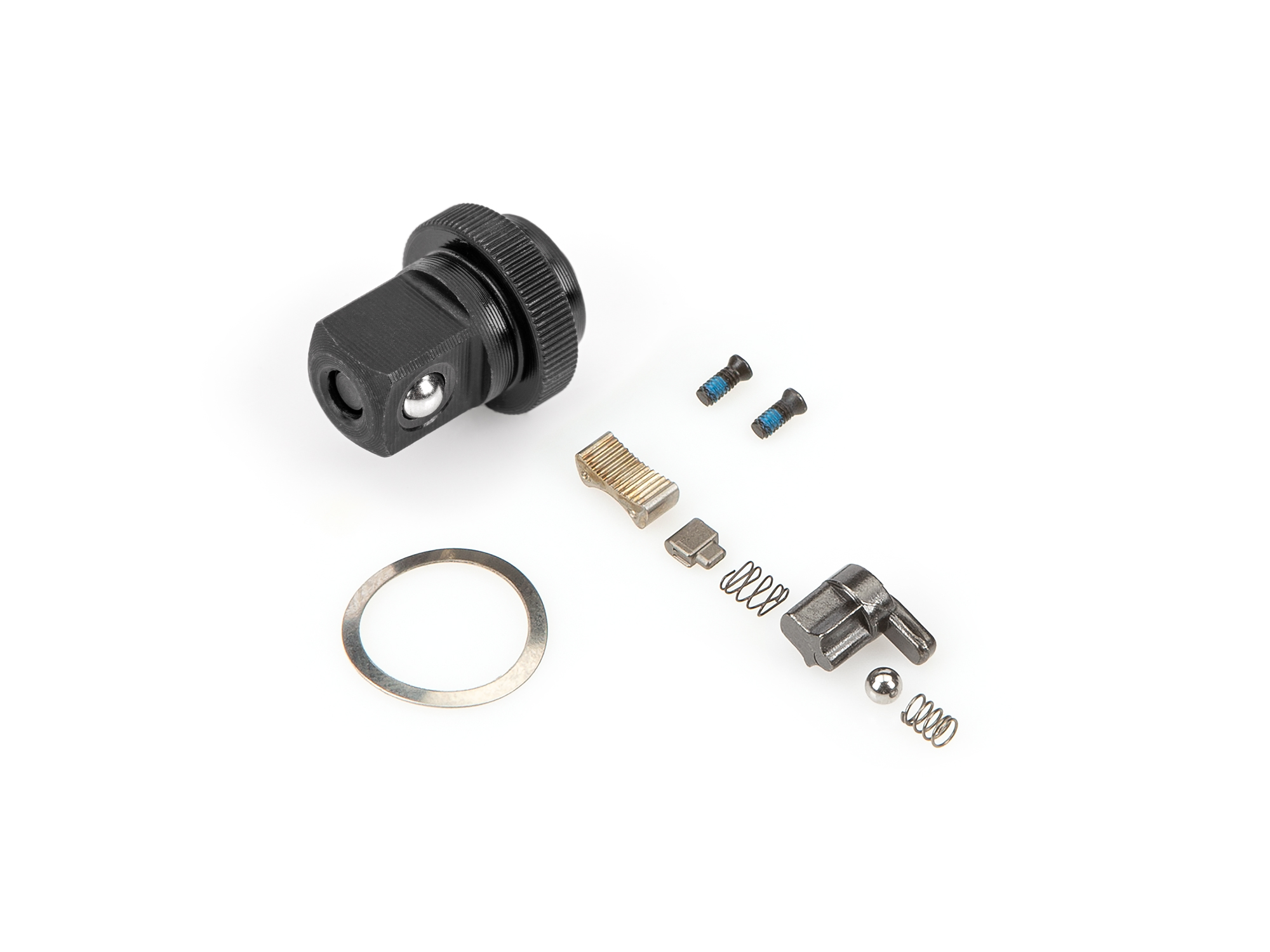

What I want to know is if I can swap the guts from the new ratchets into one of my existing 1/4" drive ratchets with one of these parts kits:
I would say no simply because, the repair kit doesn't come with a gear cover and the 3/8 won't fit through a 1/4 drive gear cover.
I wish I had some measurements because these look awfully close to my eye. 3/8" in 1/4" body on left, 1/4" on right.
Edit: both quick-release

He’s referring to the backplate, which the rebuild kits don’t come with. One may get away with drilling/boring out a 1/4” backplate to accept the 3/8” anvil, though.

I'm not sure what you mean. I'm showing the comparison photo illustrating that the diameters of the two circular features appear to be the same (to the naked eye looking at a photograph) on both parts. If both parts have the same diameters, then there's nothing that would need drilled or bored to get the new 3/8" part to fit.

He's talking about the flat plate the anvil protrudes through. The one you take off to replace or oil the 'guts' of the ratchet. A 3/8" anvil won't fit through a 1/4" plate.

The plate doesn't have a hole sized for a 3/8 or 1/4 anvil, it has a hole for the circular feature between the anvil and the toothed drive gear on the screenshots I posted above.

Ah, I see what you’re saying now. I’d be surprised if it wasn’t a direct swap.

Hmmm...you may be right. I'll have to look at my ratchets. It would make sense if they all (1/4, 3/8, and 1/2) could use the same cover plate by standardizing the base of the anvils.

Looks like the kits comes with everything you need except thread locker for the 2nd backing plate screw

First off, I was wrong. The gear covers are the same size on the 3/8 small body ratchet and a regular Tekton 1/4 ratchet. The center hole and the rest of the cover matches each other, only the part number is different..

Not sure if you're serious, but it must only be on the other side of the screw, or that it should actually be there and was omitted in production.

Looks good! Their site does state that the rebuild kit can be used to convert existing 1/4” ratchets if anyone was curious. For $9 I went ahead and ordered one to try out.
Thanks for sharing that. I have a 1/4" Tekton that I have a near duplicate in a 1/4 Gearwrench 90T, so I'll probably convert the Tekton. Please post some pics when you convert it and let us know if any issues.
