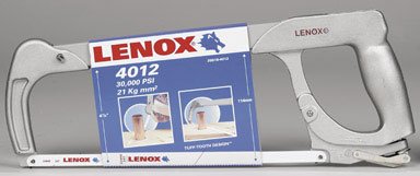

Is this the hacksaw (Snap On HS20) you're thinking of?
I'm not sure if Lenox was the manufacturer, but the Snap On HS20 is the same as the older Lenox 4012:
Both are USA made. I snagged a USA Lenox 4012 like the one above off of eBay. The 4012 was updated with a more ergonomic design then eventually replaced by the HT50. I'm not sure if the "ergonomic" 4012 was still made here:
