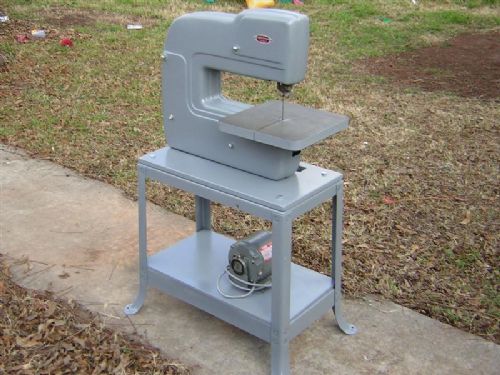

While waiting for a couple of phone calls today, I got a chance to work on a new idea for the uprights for the wing I'm going to make. But to facilitate that, I decided I was not going to be getting the time to do the loving restoration of the band saw I've had sitting in my garage for the past year or so. So I decided to simply do the minimum amount of work to get the saw running, which involved a discarded wooden shelf and a couple of scrap hinges.
I've never actually owned (or used) a band saw. They're cool!
World's quickest (temporary) belt guard:
Here's the idea I worked out for a new upright design -- the new ones will be a little wider and a little shorter than the old ones.

In between the baby's two week check-up and a parent-teacher conference for the kid, I did a little quick work on the ugly saw. As you can see, it needed some paint and a little cleaning.
And here are the case pieces after a little clean-up, scuffing and some Rustoleum.
You can see the temporary belt guard looks a little less obnoxious in black. I've got the table part soaking in Evaporust. Then I've just got to finish redoing the tires on the wheels and let all the paint dry so I can put it back together.
Here's the logo plate, re-riveted on. I think there's the basis for a good logo for the '1950s Craftsman Garage' in it.

I had to finish the saw by six, and I barely made it. First, I routed the edges of the base board and painted it with the same gray color I used on my car's gas tank.
Here's the inner structure and the motor, bolted in place.
The temporary belt guard and both sides in place:
I got rid of the rust on the table and painted the sides. The trick to masking off the top surface only? Turn the thing upside down and spray it. Everything gets painted but the (inverted) top surface.
And here she is, in a very messy garage (but hey, I ran out of time -- you can see the little hand is on the six).
I still need to finish the tires, but it works. :beer:
