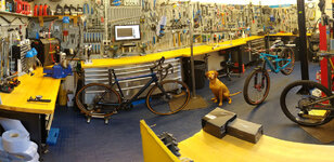

Seized seatpost removal tool I made (while we are on bike tools)
Workshop (if people are into bike tools)

That tool is very cool and impressive, I really like it. It's probably not a factor for most, but without legs that press against the ground, the forces appear to be seatpost vs. BB shell? If so, does that assume the forces required to remove the post are less than the force required to push the BB shell from the frame?
Yes the tool mounts on through the BB, so you could potentially pull a frame apart. I cut a vertical slot in a lot of the alloy posts seized in carbon frames before removal (made a depth adjustable hacksaw blade holder so I could cut a slot without damaging the frame)
Its not a perfect tool, just one I made when I had 3 bikes in with seized seat posts one week, and modified it as needed. Became a bit of a thing though and i got a lot of seized seat post work!
