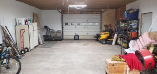

Figured I'd go ahead and throw an update on here...better late than never, right? :D
Well, since I originally posted this thread, my whole life changed in nearly every way. Thus, my plans and schedule changed as well. I just began construction on the garage 15 months ago, and at this point, it's at about 95% complete. I've realized I actually don't even have any good pics of the outside, and the inside is still a bit of a mess. I'll try to get better pictures soon. The primary use for this space will be a combination of woodworking, gunsmith work, and beer drinking/dart throwing. I wish it was twice as big as it is, but it'll do for now.
The shop is 24x45, 2 entry doors, 12x8 garage door, no windows, gas heat, 100amp service with 49 outlets on 8 different circuits, plus 2 separate 220v outlets. I wanted to make sure I always had an outlet when I needed one and that I would never be in danger of overloading a circuit :thumbup:
The exterior pics are from around June...I just got back from vacation and my mower was out of service, so ignore my yard lol. The garage door was a used door I found for $200...a deal I couldn't pass up. It's 12x8 and I had a real issue trying to find a door locally in that size, and all the shipping rates I was quoted were outrageous...bringing the total cost of a door + shipping to over $3k in some cases :shocking: I plan to paint the window frames to match come spring time and it'll look 10x better than it does now.
