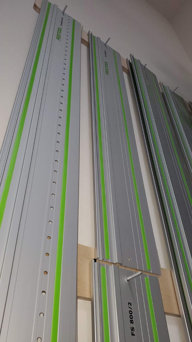

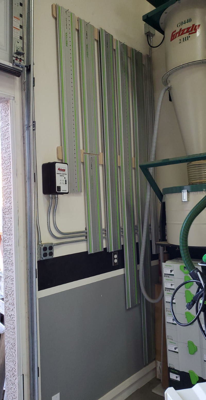

I needed to cut some plywood. Great, I have all these rails to choose from, lets get it done. The only problem is, they are all in their shipping boxes tucked back into a corner so they were protected. In other words, a PITA to get to.
My first thought is to find another solution since I really don't feel like digging them out. Instead I decided to stop being lazy and dig a 55" rail out. 10 min later I had the rail out, only to discover the clear cut strip is coming off...:wtf: This rail had only been used like 4-5 times. This shouldn't be happening already. I suspect its primarily from the heat during the summer time here in Phoenix. The box was leaning against the wall in such a way that the weight of the rail was also pushing on this strip. Granted they don't weigh much, but that also could have contributed to the strip adhesive failing.
I have realized that if something isn't easily accessible, I wont use it. If I don't use it, its a waste of money. Maybe I am just lazy, but its the way I am. I need to make these rails easily accessible, organized and protected since they are expensive. So I am came up with a rack that will hang them all.
The next question is where to put it? The perfect spot is the wall right behind the dust collector. That's when the analysis paralysis kicked in. I cant do that, that's where the mill is going to go etc etc..after 20 min, I came to the conclusion, it might be years before I get mill, if I ever get one. I might not even be in this house by the time I get one. I wont have all that much time or money into the rack. Even if its only up for a year or two, the ease of accessibility and if it keeps the strips from failing, it would be worth it.
Its a simple piece of baltic birch screwed to the wall with aluminum rod sticking out. I drilled a slightly undersized hole at a slight upward angle, and pounded the round into the plywood. Simple and effective. Its made using the rails 1000 times easier. Unfortunately its going to come down much sooner then I anticipated, but not because I am getting a mill or moving. I will get into that later.

Are they thin enough later to go above the rear overhead door. Yeah the door would have to be closed to access them but that's easy enough. That space is kind of a dead wall for anything that's not super thin....? At least it ends up utilizing a space that is somewhat unusable.
I
icecactus
May 17, 2011
302
It actually would fit behind thickness wise easily. But my longest rail is 118" and I should have around 96" above door. 16' ceiling minus 8x8 door leaves ~96". So the longest rail wouldn't fit and I would like to keep them all together.
I would have to utilize a ladder too which would **** and makes it not really easily accessible. If that long rail would fit, I would still seriously consider it though since you're right, it would be a really good use of space. :thumbup:

K-P-CxRtP6dzSABw2gT3QawzH8-vjOm8bsd3nKksxSfTqD_xgtjdwBgkO5j9tL4i9ya4V8L2WpnVjAhLJhQnPvFlzZt7seLzvyOt7FeCuZE_4w7KLVZalBC4J-5HvWeblTT65E7da-al8SLev5HcNitDsK7NZ9u8kH6CJB0vejW4jCxQedBZOcw-XTepkQkDW6qrphpKmEcjkInpnttv1rZjrHpF_p3ITzmFpfCq4WBNEnUSc-4gzmlCFeBh-B647d0T0T1RVuVwU1BGIgRAWZkDfa9ZGkXKYvH1ZK1hX4UPlU0ehDiZQ8waBpNtaPZiW3ruSHCpvmoK90U0sbkXhF454jehxEbXkUsFLg5JRij4PPuV_fgdPmzms5qfS9KE7YcnD1dNEkz-lFFSFydU-mZuaM9Gl4wKdpTE33lUdqtWROFE6MSjMqHL4e3JJ-TgupU0NWR0lHS-Wzwl5n-3PGT6pH28OqikzEV8UB6SFgmN5zrHa55QYdYMaY5OLmWY7BVPn5777M5QMwxT_4IX7JQrW3hYeCRf-yRhL5NfcNkKlK5himUZe1s6n4wh01EpCfJ1h5YY9KAgyvsMis5TPpanbrRjxQREuqWXfWrECnAlExnkigwKdxhNqLyjZFD0DJyevedBfptaEO_5VZFqaA0GBWDqzoq03mj5l4MyBGmEJXcUBGmhbPskeb2zIZTY80DmlACLxJhimdbj61cw7Sbo78SW_SmpU_qupwJAjF_ZRMtN_g=w400-no-tmp.jpg
And finally painting the wall behind the shelf to match the rest of the garage.
