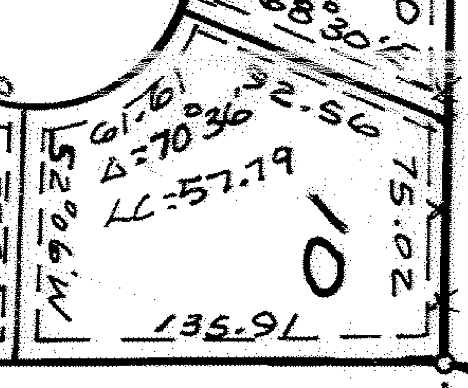

We have a bit of an odd piece of property. It's about .3 acres and oddly shaped. This limits a bit of what I can do as far as size and location goes. In the photo below the brown box is the deck we just added, and the yellow box is the current proposed location for the new build. To the east of the property is a church parking lot, and to the south is a school playground; the white rectangle on the south end of the property is a gravel area where the previous owners had a swingset -- it will be removed. The house has an existing roughly 20'x20' (internal) attached garage.

Is the 7' utility easement 7' on both sides of the property line, or 7' centered on the property line? It would be cheaper to use the existing roof line and side wall by extending off the side of the existing garage and use the existing pad. Setbacks might be dealt with by fireproof construction on the part that impinges on the setbacks.
D
drooartz
Jan 26, 2010
228
Utah, USA
7' easement is around the perimeter of the entire property (see dashed line below) -- so it's 7' into my property as far as I know.
I'll have to do some measuring on the side of the property to see what's possible.

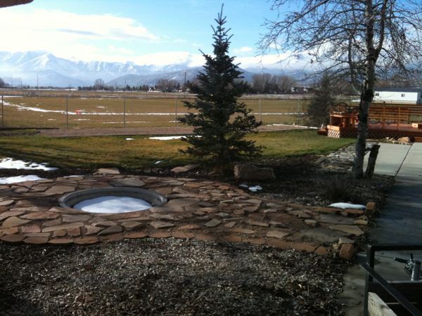

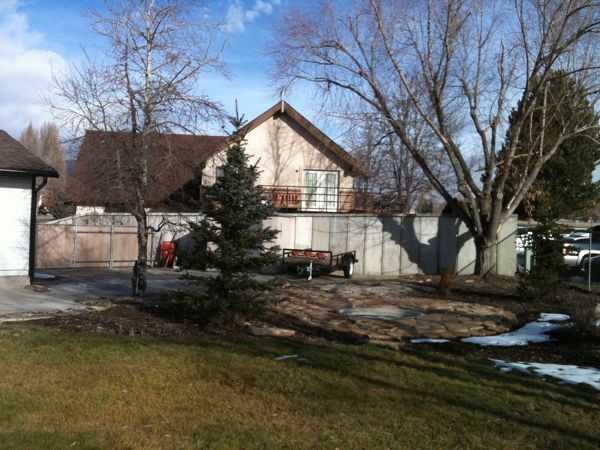

Here's a few shots of the proposed location for reference. The rocked-in fire pit would be where the new shop would go, extending towards the house and possibly overlapping the existing garage by a few feet (the pine and aspen tree will go). The existing concrete pad would stay, though the bit that extends into the back yard at the rear of the house might get shortened up a bit to make room for the new shop.
So the revised plan is same location and orientation, but 24'x24'. Thanks again for the thoughts and ideas, gave me lots to think about.
