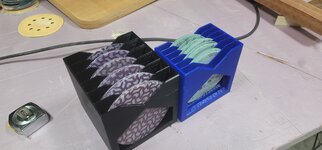

Quick design to hold sanding disc's for random orbitals.
Blue was first with 1/2" wide slots, thought they were a bit tight so quick tweak then 10 hrs later have black with 1" slots. I like the fit of the disc's in the black one better, so have another one running overnight. Will have to come up with a label as well
