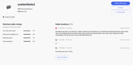

So, I bought a fake Milwaukee M18 battery off eBay a few days ago. I didn't realize it was fake until after the fact. Since I know we've got a BUNCH of M18 users, and the legit batteries are very expensive, I suspect this would be a topic that would be helpful for lots of folks here.
I'm going to go first, but I would appreciate input from the rest of y'all.
Here's my input: Buy from Ace Hardware, Northern Tool, or Home Depot. Yes, the batteries will be more expensive there; that's because they're legit. If you buy from Amazon, I think you may still get legit batteries, but I think you still run a decent chance of getting a fake battery from Amazon.
If you buy from eBay, you're likely to get scammed, just like I did. I bought a 9.0 battery (yes it was listed as a legit battery), which should have been the first red flag since these haven't been produced in several years. The seller had 100% feedback (I fixed that today with negative feedback), but had only been on eBay since July 2023 (another red flag). The battery shipped from California, but the seller is listed as living in China (huge red flag). Another red flag - the seller only sells new batteries - M18 and DeWalt - how would some private individual legitimately get their hands on hundreds of authentic and expensive Milwaukee and DeWalt batteries?
There are several other telltale signs, but I'll let someone else chime in.
Here are a few screenshots from eBay.

I'm not questioning if it IS legit or counterfeit, but how do you know it's fake, and have you contacted the seller (through Ebay)?
Yes, I contacted the seller. Said it's fake, I want a refund. No response yet.
I knew it was fake by the screws on the bottom; didn't even have to take it out of the packaging. Milwaukee uses only Torx head screws, and the two on each end are security head Torx. This one uses regular Torx (not security) on the ends and two Phillips head screws in the middle. Dead giveaway.

Oof that is a pretty good looking fake.
Try running it through the Milwaukee Online Warranty database?
Yes, it is a good looking fake, and it's much better than an "open box" purchase without the original packaging.
However, check out the packaging compared to the legit battery that I purchased. The legit battery on the right has packaging that's flanged, ribbed, and perforated. I suspect Milwaukee does this to differentiate their packaging from fakes.

Yup. First sign was that the item ships from the United States but if you look at the actual seller location it shows them as being from China. Almost every item like that is a scam.
Same with buyers. If there is a sketchy looking address (NOT a freight forwarder) and their profile shows them in a foreign country, it's a scam.

So you saw all the red flags, saw the packaging looked off, but you still bought it anyways? Why?
I bought a 12.0 off Amazon. I did my research first, and everything checked out.
I didn’t do any real research until after I made the purchase and realized the seller was in China. At that point it was too late; it had already shipped.
Yeah, when I saw that, I knew there was about a 99% chance that it was a scam. By then it was too late.
