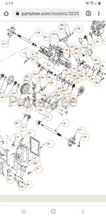

Glad to have a few of you following along. So here is the explanation of the work needed on the Cub Cadet. The problem that I'm currently experiencing is that the rear axle is leaking and making a mess of the shed floor. It's been a slow leak but it is getting worse and I want to address it before the weather gets cold.
Cub Cadet decided to use bearing blocks with integral seals to seal the axle shafts as opposed to regular press in seals on this axle. They look something like this-
Listed as numbers 4, 5, 6 and 10 on this schematic-
In Cub Cadet's infinite wisdom they decided that you would not be able to purchase just the seals, you had to buy the whole bearing block and seal assembly. And then they further decided that they would discontinue the part altogether so you can't even get the bearing block. After a bit of Google researching, I found that someone on a tractor forum figured out that the seals used on those blocks are a double lipped 30x40x4mm spring loaded oil seal. So I was able to find those seals from Motion Industries and order them and I will be changing out the seals on the blocks. They were $4 each and I needed 6 of them. I ordered a couple extra just in case but I should have them soon.

Replaced some axles seals in my Cub Cadet Tractor. It was hemorrhaging fluid all over the floor for a while. 20220823_133407.jpg20220823_133434.jpg
