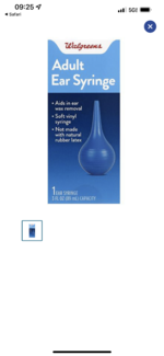

This. And use a Ear syringe to blow the dust out of the hole. I’ve seen some of the larger hammer drills kits come with a syringe for the dust.

I blew out the holes thoroughly with my compressor so there was NO issue with the holes having dust.
